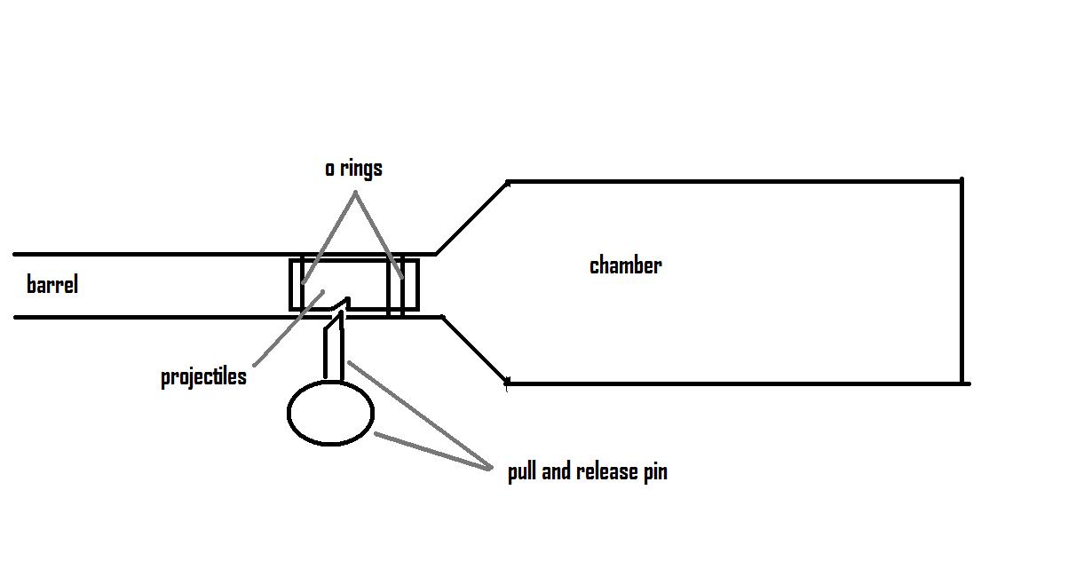

projectile/ trigger system and chamber all in one.
novak
Posts: 4
Joined: Fri Dec 03, 2010 12:08 am
well i've been trying to think off the most simple way to make the fastest valve. which got me to thinking of just using the projectile as a plug which is locked in by a pin.
by drilling a small hole in the barrel for the pin to go through and lock into the projectile. using o rings wrapped tight to seal the barrel.
pressure loss by a very small hole would be minimal.
this system also could be worked into a cartridge style depending on size. or just a simple single shot pre made device.
basic paint design
basic paint design
i've done it.jpg (35.38 KiB) Viewed 3907 times

No reason why it wouldn't work, but I'd consider putting the o-ring after the pin (to prevent tearing them if you intend to reuse these projectiles) and simply seal the pin mechanism.

o rings are cheap anyway so im not worried about them. i'll need to make a test gun and see how it all goes first

The problem with this sort of system is that you're greatly limited to certain types of projectiles. If you substitute the seal and detent for a burst disk however, you can get practically identical performance and shoot whatever fits in the barrel, something like this.

The concept is sound, but restraining the forces involved requires some pretty substantial construction

I like psycix's "air bumper" suggestion, it's probably the best way to stop the thing destroying itself:

im not fussed by that and i dont care how loud it is.
and i want simple. the only hard part is working the trigger into a stock. besides that its pretty much a combustion cannon with a little hole in the barrel. if i can get it to seal it'll work great imo
novak wrote:im not fussed by that and i dont care how loud it is.
The point was that to shoot irregular objects, you'd need a sabot, and to avoid making new sabots every time, you might as well catch it, and one of the advantages of doing that is retaining the propellant gas which cuts down on noise.
