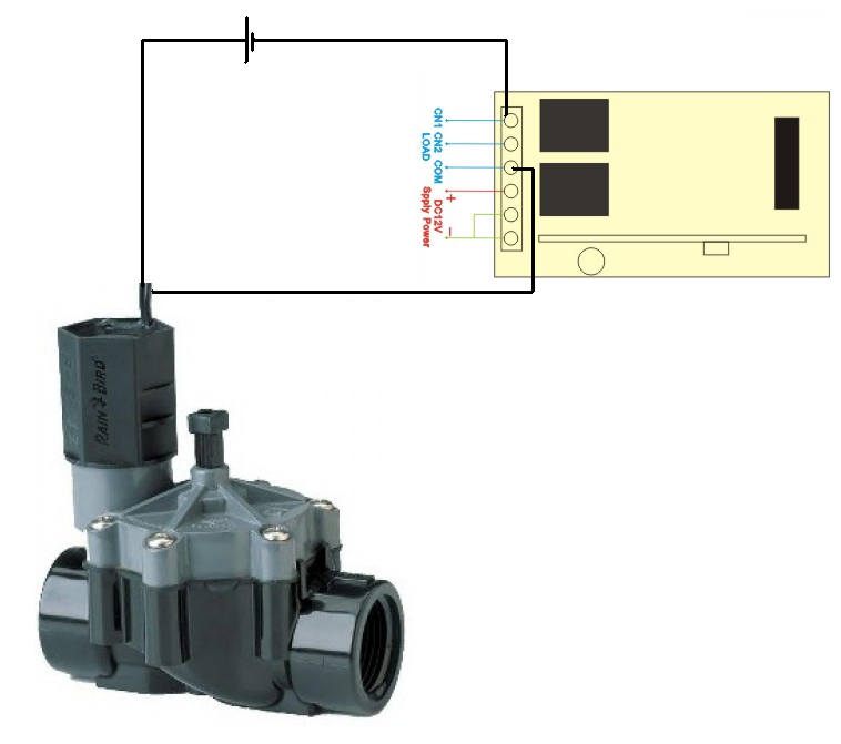

I imagine the circuit would be something like this:

Great, thanks for help JSR
