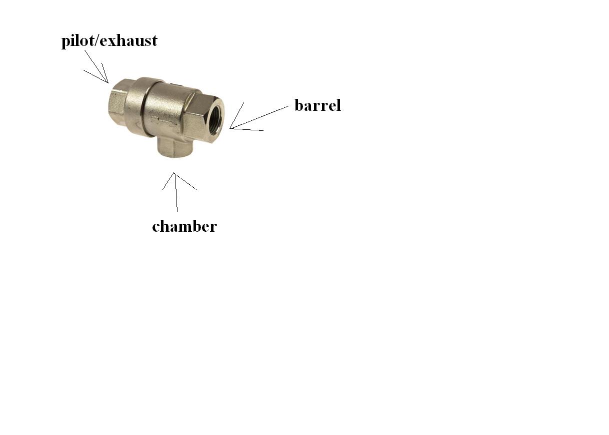

what goes where?- there are 3 ports on the QEV- and which one does the barrel , chamber and fill/exhaust go into?
sorry i just had a COMPLETE brain fart and totally forgot
how to "hook up" QEV
This Way

Are there arrows on it?

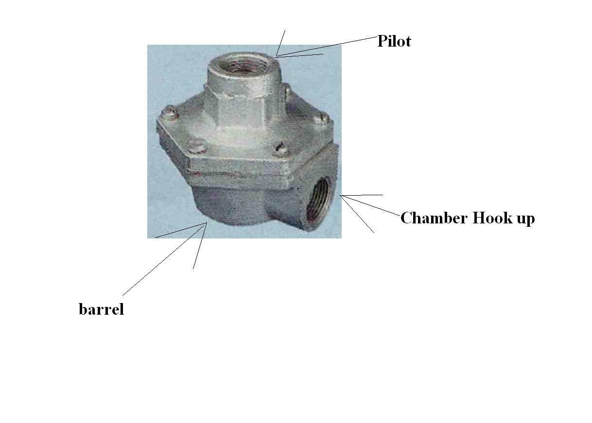

Like this one, it is placed barrel side down.
Ok the mcmaster ones have words on them.
The Exaust is the barrel, The In is the fill/pilot
The Cylinder or Cyl (it says cyl) is the chamber.

@ilovetoblwthingsup -> yes
Remind the construction of a barrel sealing piston valve, QEVs basically are that and so, the chamber is basically always on the side port.
For the remaining ports, watch the arrows. If there arent any but there is text look for "IN" or something like that, it has to be the pilot, since air goes in (and out) the pilot, but not in the barrel.
