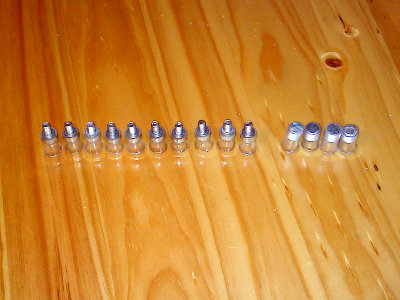

Used a 10mm fish tank hose and a 13mm steel ball and made the hose flare out to make the tale of the "pellet" work awesome in my 15mm copper barrel.

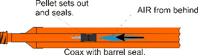

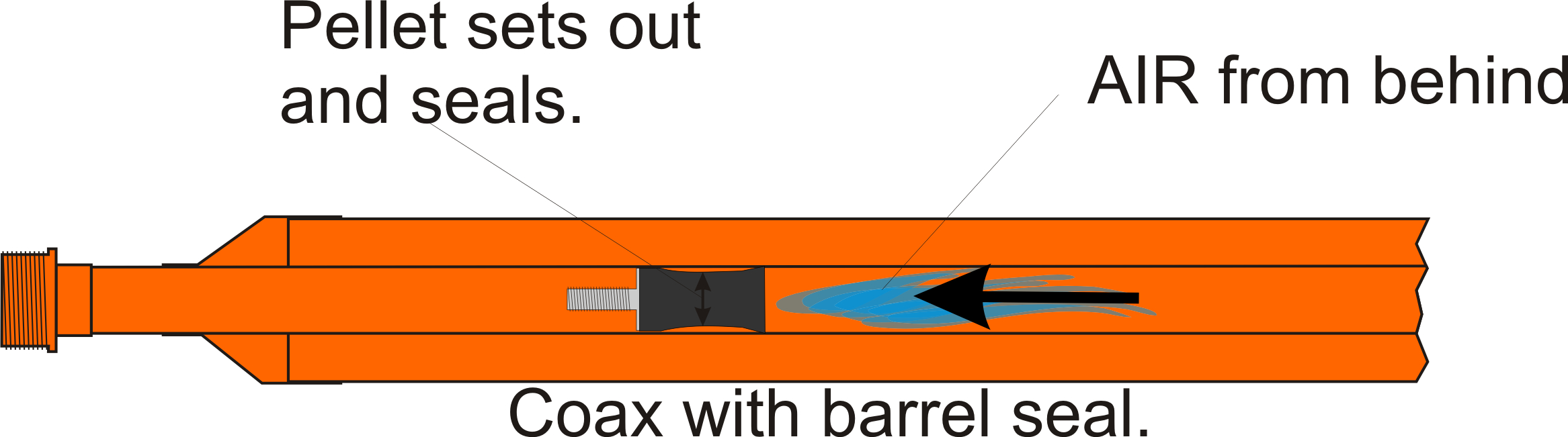

its real tight i have to push down on the pellet in the barrel then hold it down so the air can pass otherwise it pushes itself out again, and if you shoot it the back opens and make the fit tighter
The one thing about a bullet that fits so nice is it makes one hell of a noise, but the power is so much better!!!!
How it works and fits

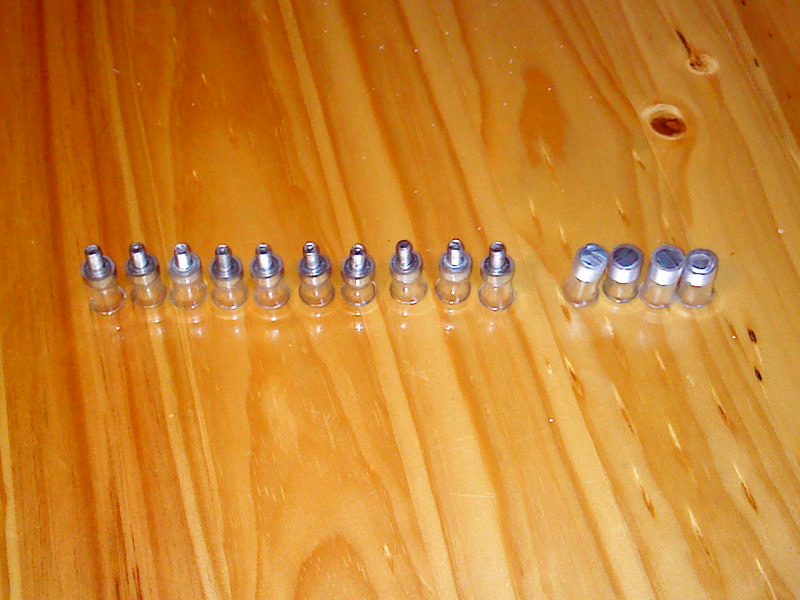

Some pellets with allen screws (left) and some sawed off thread bar (right), the Allen screws rock!!!!
The bolts i use and a little Q-bond to stick it.

The hose both acts as an tail AND it enlarges the diameter of your projectile.
