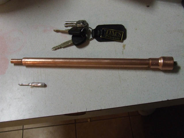

So here is a small little thing I made with a few spare pieces of copper I had laying around. While one of the simplist launchers I have made, it was also one of the toughest to make.
So anyways, there is nothing too special here, nothing that has never been done, but I am proud of my first working coax.
Performance wise, it is nothing spectacular, as to be expected from something of this size. At 400 psi I was able to sink a nail 3/4 an inch into a 2x4. Around 100 psi and I am lucky if the nail sticks.
specs...
valve... coax epoxy cast with a rubber washer. actuated by the schrader.
barrell... 1/4 inch copper around 10 inches long
chabmer... 1/2 inch copper around 9 inches long
everything else... epoxy
the full thing assembled...  and a nail dart next to it.  the keys are for size reference.

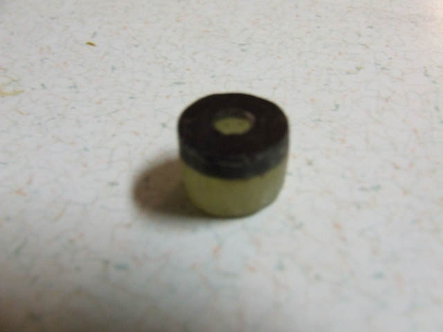

the piston
the piston

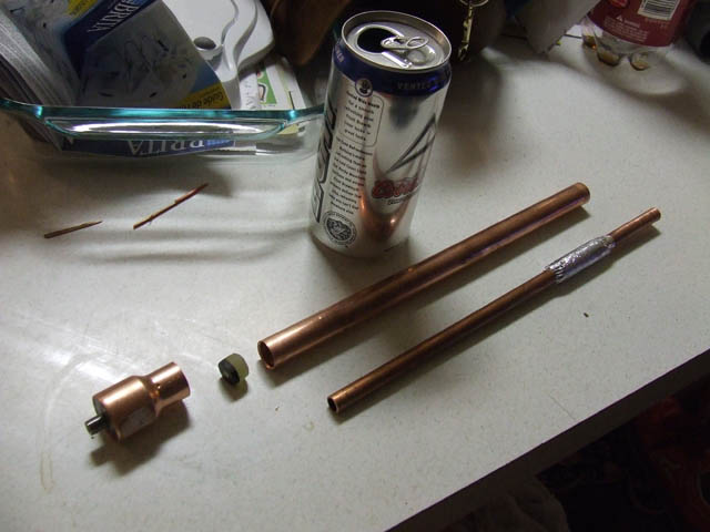

here are all the parts before it gets epoxied together...
