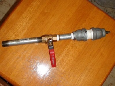

I threw this gun together out of spare materials. This gun is very simple but powerful. i use dowels as bullet even marbles also works great as a water gun.

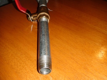

BARREL: 1/2''steel
TRIGGER: Ball valve
CHAMBER: 1/2''nipple,2reducers,1''nipple, all steel
OVERALL LENGTH:13''

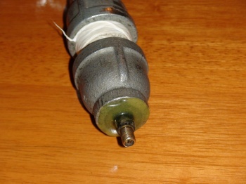

I epoxied a tire valve into The last reducer.
the gun
the gun
barrel
barrel
schrader
schrader

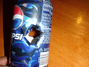

entry wound
entry wound

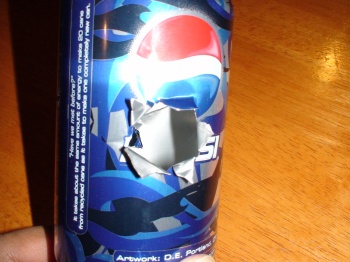

The exit wound
The exit wound

Its simple and short. What pressure are you using this at?
It just screams for 400+ psi you know...

300psi :twisted:

Even while ball valves are barely accepted, don't forget that the slow opening time has even more effect when the barrel is short.
The combination of ball valve and short barrel just isnt right.
