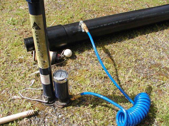

A smaller EQ port or a better seal is required. Until 2 weeks ago, all my cannons were hand pumped. My hand pump died and I bought a very small compressor for $60.covey12 wrote:is a rapid amount of air need to fill a 2" piston, because i have the feeling my bike pump is not putting out enough air to even push the piston, should i save up and get a cheap compressor?
Could you post details on the 2 inch piston cannon? How is it sealed? Is it filled through the pilot? Photos are helpful.
Attached is a photo of a 2 inch piston under pressure test with a hand pump.
Problems with the piston sealing face can also prevent filling as the valve will fail to seal against the barrel. What are you using for a seal? Is the valve seat true and polished flat?
