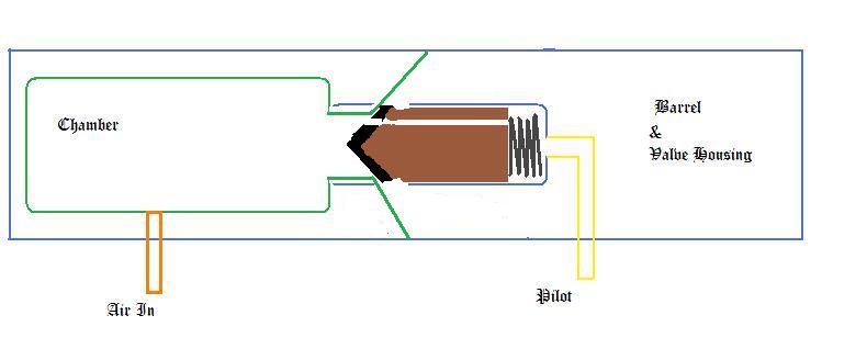

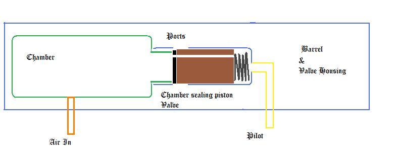

Now I'm not sure weather to actually call this an inline valve but more of an inline style valve because of it's design.This is only a rough design that popped into my head a while ago when I was working on the Blow off Valve of a turbocharged car.I've been out of spudgunning for a while now as some of you may know so my design might not be perfect and have some fatal flaws that I haven't discovered.
Well here it is a rough drawing.Hopefully it gives you an idea.
I will go further into detail and design when I come back from my shopping.

As long as the piston was airtight it should work. I don't think performance would be amazing compared to a normal fully ported piston valve, but it looks like a solution for someone making a replica of a Bazooka type rocket launcher.

why not just make a toolie going through the chamber it would be easier to make, it would probably perform better, and you could pilot it from the back
Because piloting it from the back isn't as good for aesthetics as piloting it from the side.
Performance for the size isn't always the #1 reason for a build.

I had the intention of building a LAW style launcher out of this design,all out performance isn't what I was chasing.More of a first of it's kind design(Has it been done?)

Of course it's going to be down sized and port design made to flow more efficiently then just simple holes.I Also have been thinking of piston design.Instead of it being a plain flat why not have a cone piston and a matching seat for the piston to direct airflow.Shown in the crappy illustration below.

Kind of reminds me of a barrel sealing version I had going on here:
http://www.spudfiles.com/forums/linear- ... rt,15.html
The problem is mounting a piston housing inside of a barrel or chamber without restricting flow.

Thats what I was worried about,restriction in flow.Although with this design I would be using either a copper or brass chamber so pressure of upto 200psi would be used.But like I said before I'm not going for just performance it's also got to have that wow factor that will come with everything being housed in a single length of 40mm PN12 pipe.
It is similar to that design,but there are differences such as how yours seals onto the barrel but my valve seals onto itself only and is then inserted in a barrel,hell it could even be used as a noise maker by itself haha.

Hotwired wrote:Because piloting it from the back isn't as good for aesthetics as piloting it from the side.
i beg to differ i think trying to making it ascetically pleasing from the back would be easier to build and end up looking better
rna_duelers wrote:I'm not going for just performance it's also got to have that wow factor that will come with everything being housed in a single length of 40mm PN12 pipe.
http://www.spudfiles.com/forums/m1a1-ba ... ter,0.html
As you wish.spudtyrrant wrote:Hotwired wrote:Because piloting it from the back isn't as good for aesthetics as piloting it from the side.
But consider the designs you see around you in here. Are they as they are because the creator wanted them to be or because they have to be due to the valve system?
Put enough thought into anything you're given to work with and you can come up with something that looks good. But you will be limited by whatever restrictions there are in what you were given.
Pilot from the side and you get an inline layout with a central trigger, pilot from the back and you have the cannon in front, pilot from the front and you have the cannon further back. Pilot 90 degrees from either chamber or barrel and you need a stacked tube arrangement to keep everything compact.
Of course you can run airlines all over the place to make up for it but having to move the pilot valve a significant distance from the main valve is a sign that the main valve isn't quite where you would really have liked it to be. You're working around the restrictions the valve imposes.
In a rocket launcher style cannon the trigger is somewhat central to a fairly long tube so a side piloting valve would be a fairly desirable thing. Performance and aesthetics all depends on how skilful the designer and builder is after that.

Like I said this is only an Idea.
I've thought of actualy using one of my BOVs for a valve.But there build isn't designed to handle pressures above 40psi at the most(Read Thin Aluminium Walls)
This is a deisgn if I was to eventuate into a launcher would be made with a lathe that I'm going to purchase when my car has it paintjob done.But until then I'm still going to try and better the designs flow and design.All no wider then the inner diameter of a 40mm pipe.
