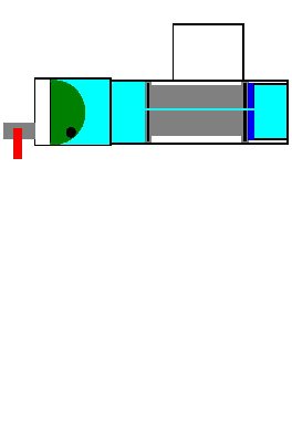

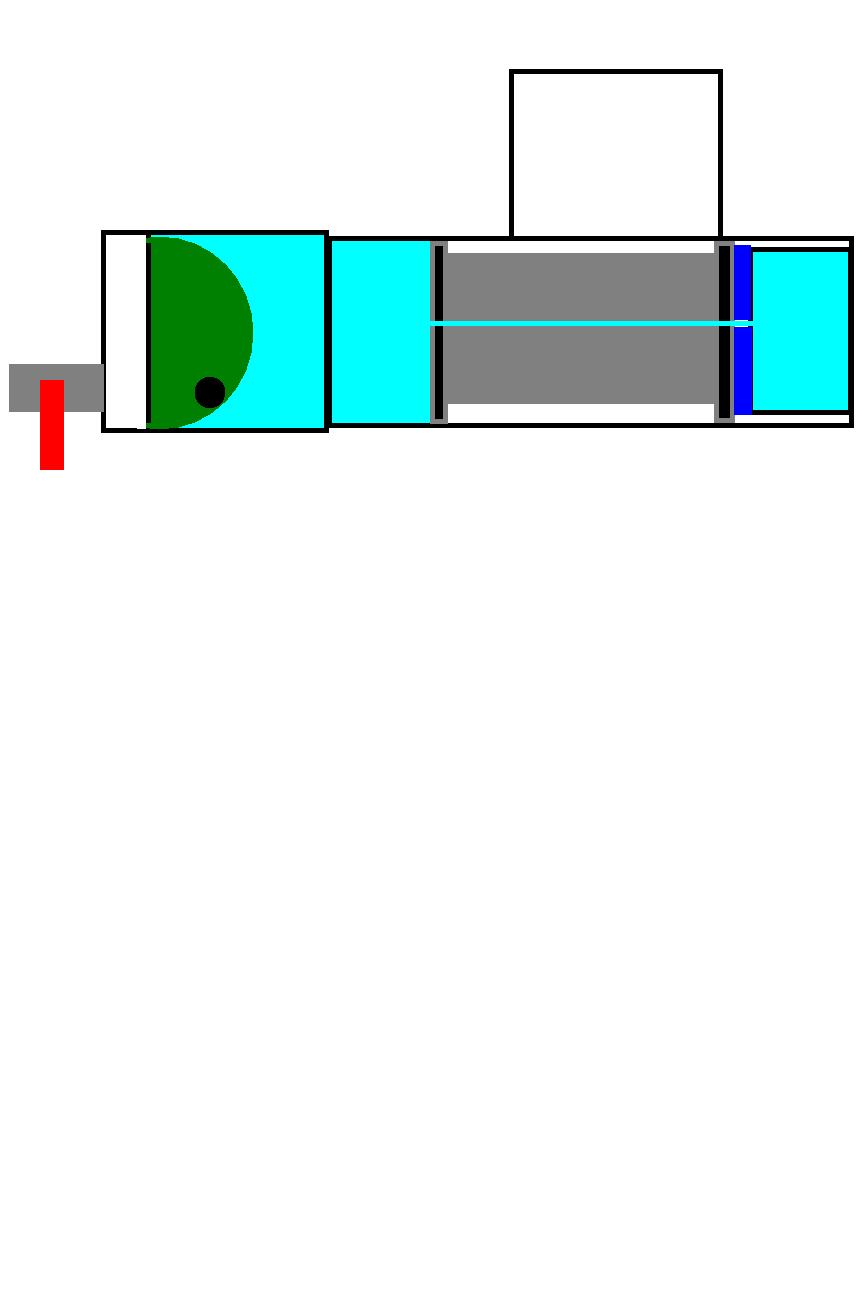

Yes yes I know its been done, Supah right? Tell me if you like it.
Light blue is compressed air, Piston seals with O-rings.
Chamber sealing valve.

It should work, but tel me, why go trough all the trouble and make a chamber sealing valve, when a barrel sealing valse is easier to make, and bether, due to less dead volume.
Nice pic though !
I like the tennisball bumper.
Nice pic though !

His works great cause its damn big.Ok, can somebody answer this. If barrel sealing valves work a little faster, why is the supah vavle a chamber sealing valve? Is there some reason why Joel makes 'em chamber sealers?
Join the spudshot forum!!!!!
How come it is every time builds a chamber sealing valve they think its a supah? Just cause a Dodge Caravan has four wheels it doesnt make it a Benz.
Yes, the concept may be very 'straight forward', but you have abused to go into how your going to implement the given system. From what I can tell it looks as if on the 'left' side the pistons movement will be restricted in its stroke to the 'right' by the 'stops' in the tee, and 'left' by the bumper? Am I right? [The lip on the piston led me to that speculation. And I havent the foggiest on how you intend the sealing portion of the valve to work. It just bugs me on you diagram that you fail to recognize any variation in obstacles, and diameter. You just drew the T as if it was straight through.
Benny, read the F-in' question.
Squeaks, to tell you the truth I dont know. Something ive always wondered, but never asked. So im glad that you asked the question. 'Performance' as you say seems as if it is one of his focal points, so why wouldnt he simply make it a barrel sealer? [To re-state the question]
Recruit, the size of the valve could easily vary, since its concept of operation has no effect to the size of the valve. Access, if were working of a T configuration on both valve it could have exact access. Performance? Have you totally missed the jist of the two, two liners posted by 'Squeaks'? Appearance, may very well be the reason. Simply, since T config barrel and chamber sealers are oriented different. Yeah im pretty sure he fancies himself since his valve is promoted and largely contested of 'god like' status among other valves.

pimpmann22 wrote: Yes, the concept may be very 'straight forward', but you have abused to go into how your going to implement the given system. From what I can tell it looks as if on the 'left' side the pistons movement will be restricted in its stroke to the 'right' by the 'stops' in the tee, and 'left' by the bumper? Am I right? [The lip on the piston led me to that speculation. And I havent the foggiest on how you intend the sealing portion of the valve to work. It just bugs me on you diagram that you fail to recognize any variation in obstacles, and diameter. You just drew the T as if it was straight through.
I will file out the stops in the tee. It will be well lubricated and should work very well. And god, this is a primative design. Sure point out the faults but it hasnt actually been BUILT YET! wait untill its done before you critisize.
You don't seriously expect it to make any kind of seal when you plan to "file out the tee" do you?
