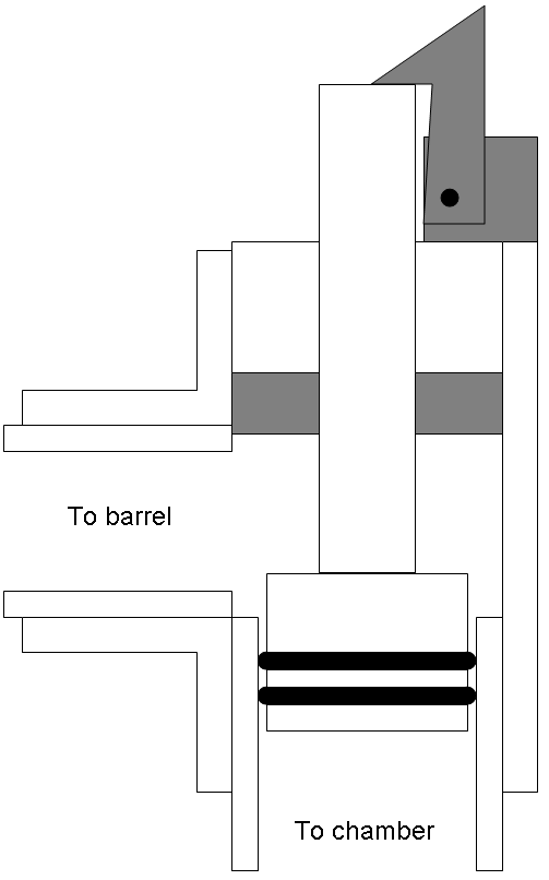

QDV vs a Mechanical chamber sealing valve
iknowmy3tables
- Staff Sergeant
- Posts: 1596
- Location: maryland
- Has thanked: 3 times
- Been thanked: 9 times
- just in case you can't visualize a mechanical chamber sealing valve, it wasn't my idea it's a very basic concept, but it's harder to make than it looks
- mechanicalchambersealingvalve.PNG (18.38 KiB) Viewed 4951 times
- boyntonstu
- Sergeant
- Posts: 1039
- Joined: Sun Jun 28, 2009 8:59 am
The O rings seal the bottom.
What seals the top?
A double set of O rings comes close to Tech's QDV.
What seals the top?

uhhh.... that isn't the best way to describe tech's valve, tech's valve is neutral it won't go either way until it is activated, the best way i could think to describe it would be a neutral mechanically activated toolie valve since it doesn't really seal against the barrel, it's more of a piston valve with a high CF.iknowmy3tables wrote:I was looking at the design of Technician's QDV
and I think it's safe to describe the valve as a mechanical barrel sealing piston valve, and I was trying to compare it to another design that I recall but can't find that I would describe as a mechanical chamber sealing valve, you can see the diagram below
plus his valve does technically seal the chamber lol

To model my valve, I lie to GGDT. I tell it the piston OD is about .1 to .2 inches larger than the valve seat.
The main difference between a barrel sealer and chamber sealer is determined on what is on the face of the piston. Is it a barrel? Is it a chamber? With that, the QDV is a barrel sealer. The face of the piston faces the barrel, not a chamber under pressure.
GGDT does not like a valve to have the piston face and the piston diameter the same diameter. It thinks it won't move as it is assuming the only motion is from air pressure, not a mechanical pull. Lying to GGDT makes it work somewhat, but GGDT is then calculating a slow start to the opening due to air, not the mechanical stroke the rod gives it. In reality, my valve starts opening faster than GGDT models an air only valve.
Chamber sealers have high pressure on the face of a piston. This will require a high pressure in the pilot area or a mechanical link to hold it closed. Due to that, when fired, the valve opens relatively early while the pilot is under high pressure. The chamber begins to quickly vent and drop in pressure. This reduces the force opening the valve and it may re-close if the pilot valve is not huge to keep ahead of the rate the chamber vents out the barrel. Many sprinkler valves are of this configuration where the inlet presses on the center of the diaphragm. A slow pilot causes honking.
The QDV as a barrel sealer (pressure on the piston side) has no pressure in the "Pilot area" so it has the advantage of not requiring a large pilot valve to quickly vent this area. It's already vented. When the valve cracks open (quickly by the rod impact) the chamber dumps onto the face and blows the valve open with pressure between the piston an projectile without any resistance from pressure behind the piston. It opens fast.
Without a linkage and sear or pilot pressure needing vented, the QDV opens faster than either a traditional chamber or barrel sealer. There is less resistance to it opening and less pressure slowing it. It does tend to beat the tar out of bumpers.
On the drawing the mechanical link is often replaced by air and a pilot valve. The Supah valve is constructed in this configuration.
Note the inlet is on the face of the piston. This makes it a chamber sealer.
I hope this helps.
I hope this helps.

that aplies to pistons and sprinkler valves of both configurations,it may re-close if the pilot valve is not huge to keep ahead of the rate the chamber vents out the barrel. Many sprinkler valves are of this configuration where the inlet presses on the center of the diaphragm. A slow pilot causes honking.
what I am saying is that the last convention I recall on barrel sealing piston valves vs chamber sealing piston valves seamed to declare barrel sealing to be always faster than chamber sealing equivalents,
which would have to make the assumption that:
(the force, in a barrel sealing piston, opening the piston, due to air pressure,) = ((the entire cross sectional area of a piston) x (the pressure that the chamber is filled to))-((the entire cross sectional area of a piston)x(the pressure in the pilot))
which is not true because of the area of the seat is initially under a vacuum
while pressure may affect the seat area once opened (and this pressure is what the QDV uses to open) the average pressure on this area is significantly less than the pressure in the chamber because of the rapid depressurization of air exiting though the barrel. in other words the cross sectional areas under pressure initially contribute more opening force per square inch than cross sectional area that is not initially under preassure
