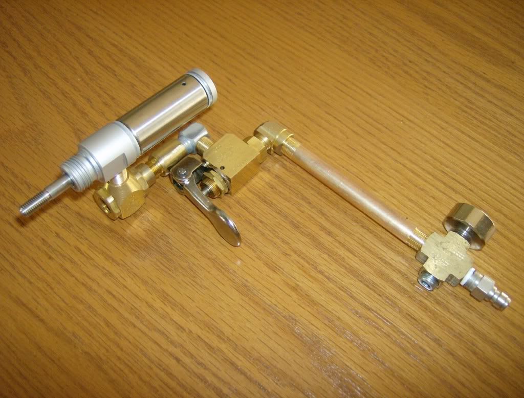

Here are all the parts before they were installed in the gun:

looks great but how was that 200$ what the brass tee bellow the acuwater
a mini qev?from a paintball gun?

@twizi: I suppose I exaggerated on the price, but not by a whole lot. I wasted a of lot money building this, it could have done cheaper. The QEV is made by Clippard, model #JEV-F2F2.

how does the qev pilot is ther a leak somewhere?
what you say ? :wink:
well my guess is that you want to know how it works, right ? well technically it's just like FANG or my semi auto...
PVC Arsenal 17
Posts: 1762
Location: United States
The way the QEV pilots is nothing new. It's very simple. It's connected to a 3-way, normally open valve. At rest, air flows through the valve to the QEV. When you pull the trigger, the valve shuts off the incoming air supply while at the same time venting the air behind the QEV, piloting it.

To anyone who doesn't understand how the valve system here works look at the images below for a test gun I made about a year ago.
Above is the gun without the trigger depressed. The gas chamber is filled during this stage.
With the trigger pressed the QEV is piloted (which in turn fires the dart) and air flow from the gas reservoir is stopped.
It's a simple way to get semi-automatic operation from piloted valves. In PVC Arsenal's gun the air is piloted out of the holes on the side of the valve. The valve he's using is very good for this purpose as it doesn't have a bulky extra port like the one in my images here.
