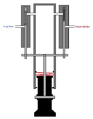

Now it gets difficult :?. The layout I have pictured should work for fueling and returning the piston. A series of spool valves are connected to the chisel so that when the tool is lifted up, fuel fills the meter pipe, and the piston is pushed to the top of the tube. When the tool is set down, air flows through the fuel meter pipe, pushing fuel then air into the chamber. Spark, bang, repeat.

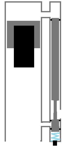

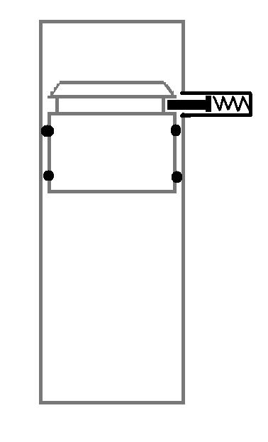

Two possible solutions I've thought about are pictured below. One would be a pin that springs into the piston as it moves up. As the chamber pressurizes, the pin is blown out of the piston and the piston is released. Only I just realized that same pressure will put significant side force on the pin which could jam it.

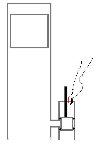

Another way would be to have a QDV at the bottom of the barrel, with a switch built in. Momentarily after the barrel begins to dump, the chamber would ignite. HGDT doesn't show much performance loss due to ignition at time of release (entered as low burst pressure in model) because of the heavy 'projectile'.
Any ideas on that would be much appreciated. And any other aspect of it of course, the aluminum rod is pricey so I thought I'd run it by you fellas in case I'm out to lunch! :D
Edit: had a :idea: moment immediately after posting - connect the barrel to the chamber with an air spring loaded spool valve and set the spring pressure to just above the preignition pressure, so that the barrel dumps before the piston has a chance to go anywhere! Did a quick sketch, I think that just may do the trick.

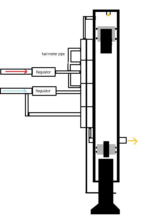

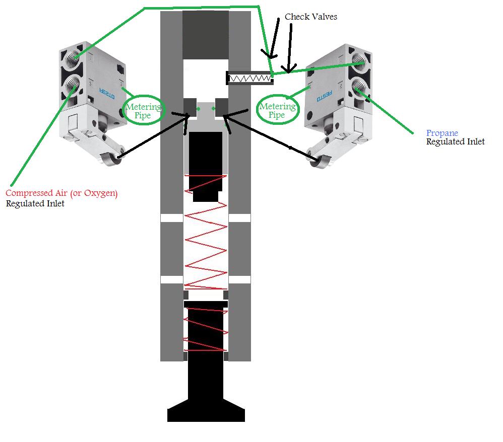

Here is what I have in mind for fueling. Not to scale and the regulators aren't shown. Trying to keep it simple for the operator so they just have to place the tool and pull the trigger. I think if the valves are large enough with a high enough flow rate and a small chamber, the chamber should fully pressurize at each step.

would a nailgun style safety be acceptable? This could be used to control fueling easily with two linearly actuated valves, one 3 way. Maybe 3 for a pneumatic auto-return. A 5 way in place of one 2 and one 3 way would simplify things
Valve one would have one port tied to the regged propane input, the common port tied to the meter pipe, and the final port tied to the chamber via a high pressure check valve.
Valve two would control air.
Operating mechanism:
Code: Select all
On pressing the safety, valve one would close off the chamber, and fill the meter pipe. Valve two would fill the chamber with air.
The optional "valve three" would open the atmospheric port, and close off the low pressure source.
BOOM!!!! :D
On releasing the safety (which should move slowly, so the "recoil" doesn't cause misfuelings) Valve One would dump the meter into the chamber, and cut off air. Possibly the 3rd valve could close the atmospheric vent, and dump air at a low pressure to re-set the piston, which would be locked by some kid of friction device.
rinse and repeat
This is all based off "hammer.jpg" in the first post. some kind of "cocking" procedure would be needed. The A BV porting the chamber to atmosphere could accomplish this (Open BV, depress safety, close BV, release safety, read :twisted: ) Or you could use a microcontroller, and pulse solenoid valves, like previously mentioned and commonly implemented in paintball guns to control the bolt/spool valve.
EDIT: I just read your post, and you have the exact same idea. (skipped to the pictures :oops: :oops: :oops:) Back to your actual problem, you should most likely make some kind of piston valve/QEV to pneumatically hold the force. You wouldn't even have to pilot it, if you made the pilot area large enough. It would be a good idea if the "hammer piston" moved far enough "down" to vent the area behind it to atmosphere. The last image you posted would put a lot of stress on the spool valves, as you would effectively be actuating them with a sledgehammer, unless there was a disconnect, like in a QDV.

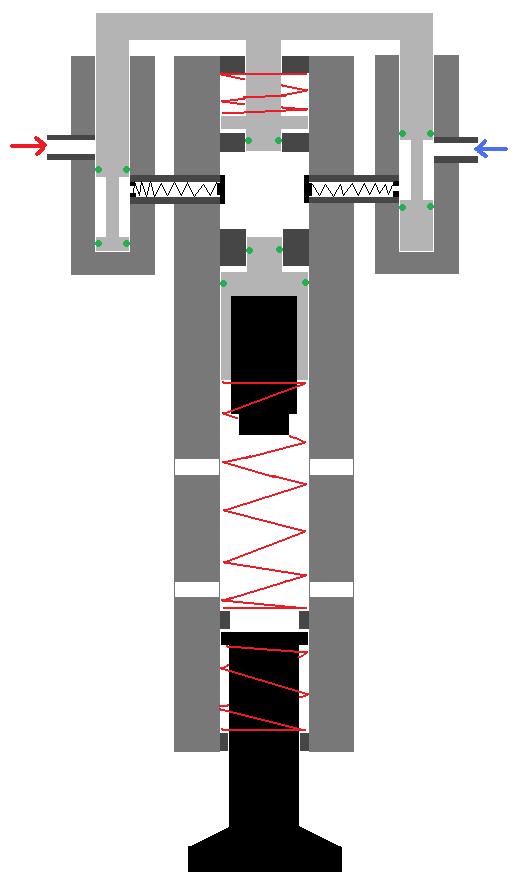

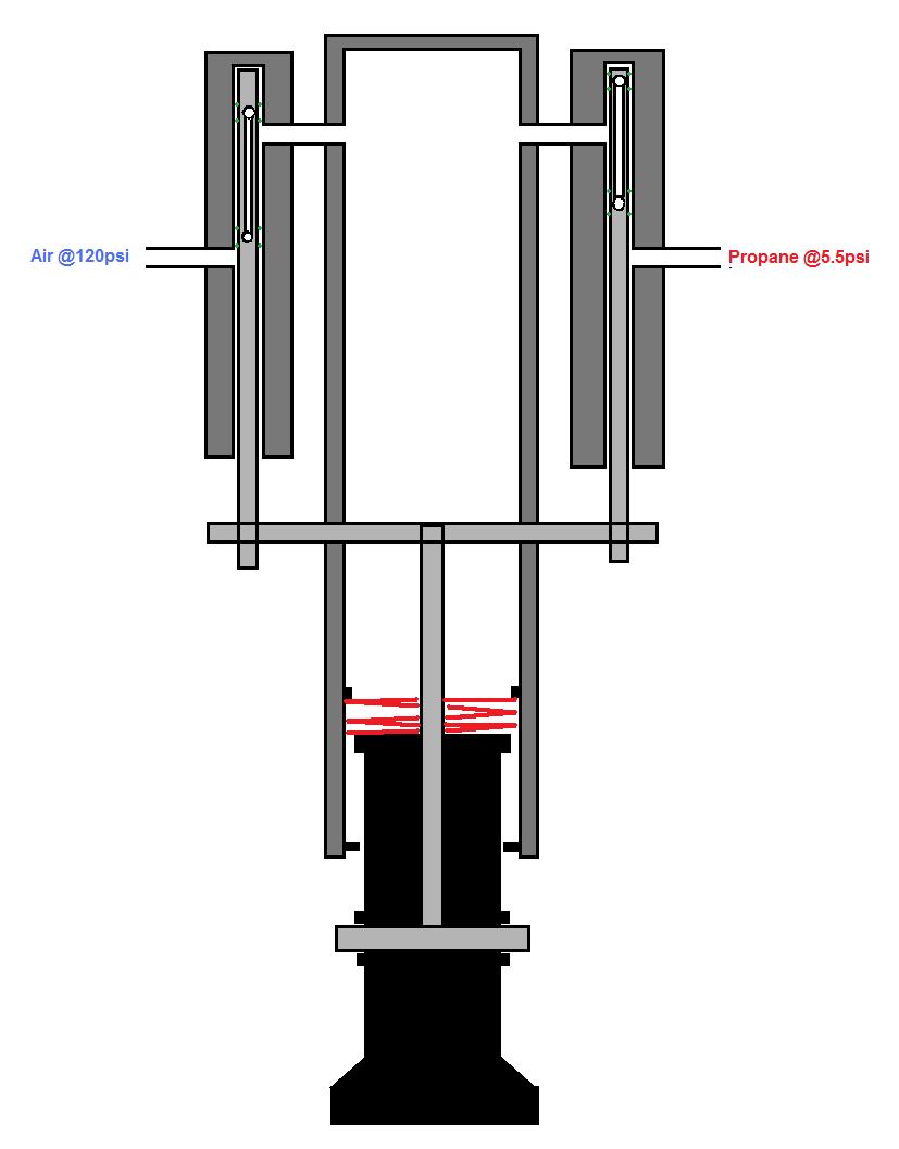

Here is a more complete drawing of a hybrid version. Tried switching the fueling actuation to be based off the combustion. But now thinking about it, it is probably simpler to have it based off chisel position, just design it in such a way that the valves are protected. Oh well at least I'll have paint skills after this :roll:.

Everything looks good, stepped piston face (good idea I must say), but like you mention I see problems with driving the fueling cycle directly from a piston as pictured.
Only thing is the piston reseting, perhaps it won't fully return close?
Anyways better then I can explain it:
Uggh what a muck, but as originally pictured just having the 2 check valves. Got carried away and now there is 3...

Long story short, I was looking into controlling meter position based on pressure spike a while ago, and I theorized that it couldn't be made to work. The reason is really hard to explain, but I don't think it will work.
When I said to use a valve, yes, I meant make a piston hybrid. Don't use a pilot valve, instead, hook up the regged down air to the (large) pilot area through a high pressure check valve. I would say just use a spring, but IIRC, in Fnord's first piston hybrid, the spring he used behind his valve (for essentially the same purpose) got pancaked. Also, to restrain ,say, 40psi across a surface of around 3 square inches would require 120 lbs of force. Once the huge, expensive spring is compressed, it will exert a lot of force on the piston, your most recent design looks to have some anti-pancaking built in, but I would rather not buy, and support a huge spring like that.
For fueling, a 3 way is not required for air. A two-way dumping the regged input will do just fine. That is to say that you should "manometrically meter" the air or O2. If you use O2, you will most likely need a meter pipe, unless you feel like a 15x hybrid minimum.
Also, I think metering based on a nailgun type safety would be a good idea. Something like this could be implemented. You could still use the roller valves, but come up with a ground down rod to actuate them by way of linear motion. It would be much easier than attempting to seal roller ports inside the chamber of the gun, as shown in pimpmann's diagram. No offense...
It would be a very good idea to make the system modular, to deal with different types of chisels, and to replace broken ones.
