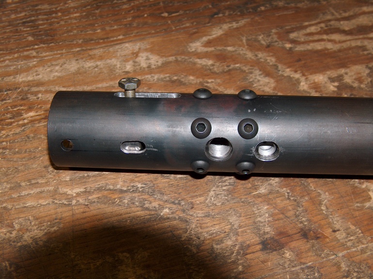

Please note the "bolt" in the slot. It's attached to the hammer. :)

maverik94
Posts: 558
AHHHHHHHHHH Ok, I dodn't realize you could click on the words! Wow, that makes me feel stupid. Anyway, I get it. Thanks a lot. I will resond when I try this out. Thanks!

Ok, Success at last!!!!!! I built the bolt cocking mech and the trigger/sear mech just now. I made the trigger out of some heavy metal and cut it to shape with a cut-off-wheel, I made the bolt with some stell brakeline and some treaded rod and the help of the cut-off-wheel and a drill. It works like a charm. Thanks for all your help. By the way, the image is not working for me anymore either, even though it was earlier. Anyway, thats not important because Ive got this working. The only bad thing is when I was testing the sear, I forgot to block the hammer and it went flying, hit a light shade, denting it()Yeah, I'm using a powerful spring), and then fell somewhere and I can't find it....damn....
