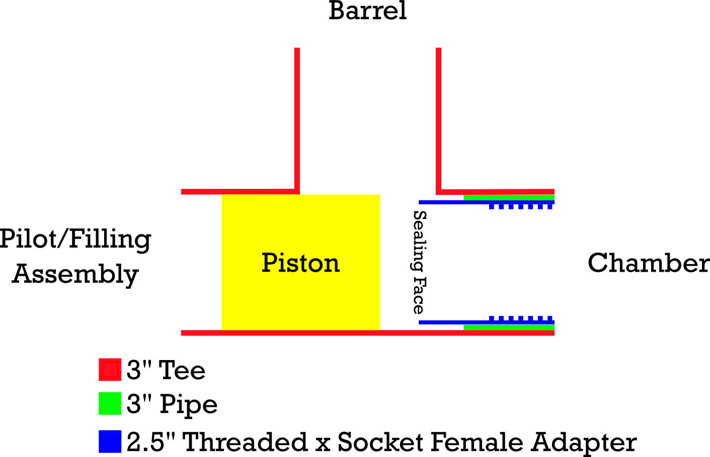

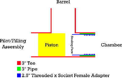

So, let me get this straight (sorry that I don't quite understand). On the Supah valve, it has basically a 2" threaded coupling inside the end on the chamber opening of the tee and the piston seals against the inside end of this coupling and you thread the barrel to the outside (threaded) end? Maybe kind of like the diagram I drew up here?mark.f wrote:The Supah valve employs a 2" coupling in the back of a standard (though cut down to fit flush in the tee) 3x2" bushing, and the 2" sealing face is in the back of this coupling.

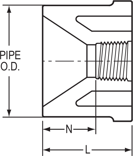

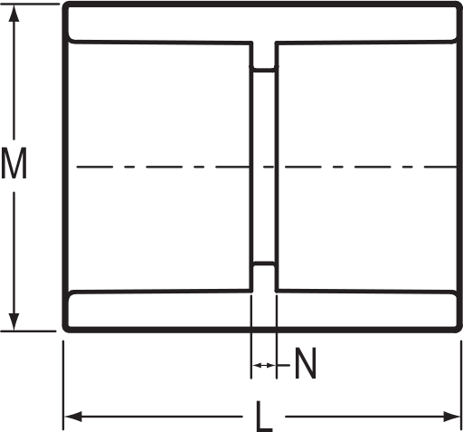

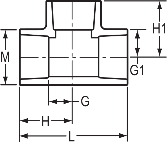

I'm so sorry (I know I'm going to come off as a pain in the a$$ that can't do anything himself), but I still don't get it. The attached pictures are what I am assuming you mean by the parts you mentioned (reducer bushing, coupling and of course the tee they go in).
- Tee (Socket x Socket x Socket)
© Copyright 2010 Spears® Manufacturing Company. All Rights Reserved. - TEE Socket x Socket x Socket.png (20.67 KiB) Viewed 4777 times
- Reducer Bushing (Spigot x Fipt)
© Copyright 2010 Spears® Manufacturing Company. All Rights Reserved. - REDUCER BUSHING (Flush Style) Spigot x Fipt.png (27.61 KiB) Viewed 4777 times
- Coupling (Socket x Socket)
© Copyright 2010 Spears® Manufacturing Company. All Rights Reserved. - COUPLING Socket x Socket.png (9.69 KiB) Viewed 4777 times

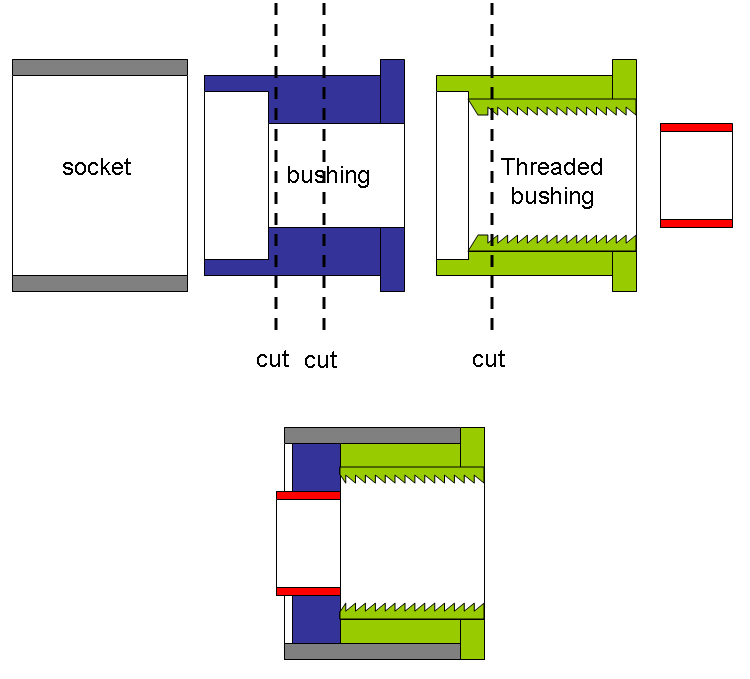

yet another relevant thread/link to mention
and I don't believe bluetooth should attempt the supah valve without a lathe
I think one important question is do you have a belt sander or similar instrument of decent grinding power to slightly trim down the outer diameter of pipes and pipe fittings? Since there is no official standard for the outside diameters of female fittings it may not be wise to design valve around a fitting attachment "shortcuts"
- threaded seat for piston valve.PNG (24.15 KiB) Viewed 4755 times
I did not intend to make a Supah valve (I obviously don't have a crazy metal lathe setup, or even a wood lathe for that matter). I have basic power tools (e.g. miter saw, table saw, jigsaw, power drill, circular saw, Dremel/roto-tool, belt sander, vibrating sander, orbital sander, etc.). Thank you so much for that diagram. It was exactly was I have been looking for: a way to have a reducer bushing with the extended pipe (sealing face), and the threaded bushing on the outside to screw barrel/chamber onto.iknowmy3tables wrote:yet another relevant thread/link to mention
