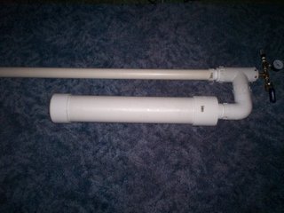

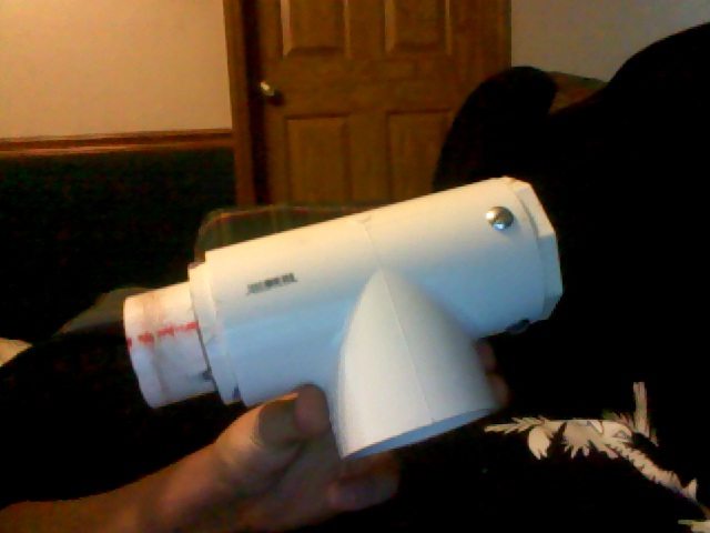

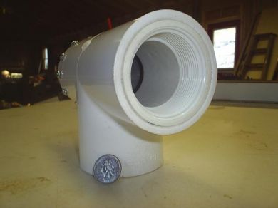

On a valve like this, does the piston slide in the bushing, or is the bushing cut down and the piston slides in socket itself? My cap piston failed so I have the rest of the gun with screw holes in the tee, I want to covert it to something like this.
- Mauler Valve from launch potatoes
- mauler02.JPG (12.61 KiB) Viewed 3891 times
- This is Dan003400 gun, or this
- dans piston.jpg (23.21 KiB) Viewed 3884 times

You already gave up? Yeah I'm pretty sure the Mauler is a compact. It has slices of bushings in it so there are no adapters sticking out.

Any idea about the new one I just uploaded, Its Dan003400 gun, I didnt give up, I decided it wouldnt work with the tools I have, and it had terrible flow when I tested it anyway

the one you just uploaded just looks like a normal compact piston valved launcher. Look around the showcase some more or use the search to find some more examples and go at it again. My parts are all ordered, pistons made, and pipe bought. Wish me luck!

They slide on the pipe! not inside the bushing.

Tthe "guide" in the diagram you posted by Gipetto.

The same way as Gipetto's.
