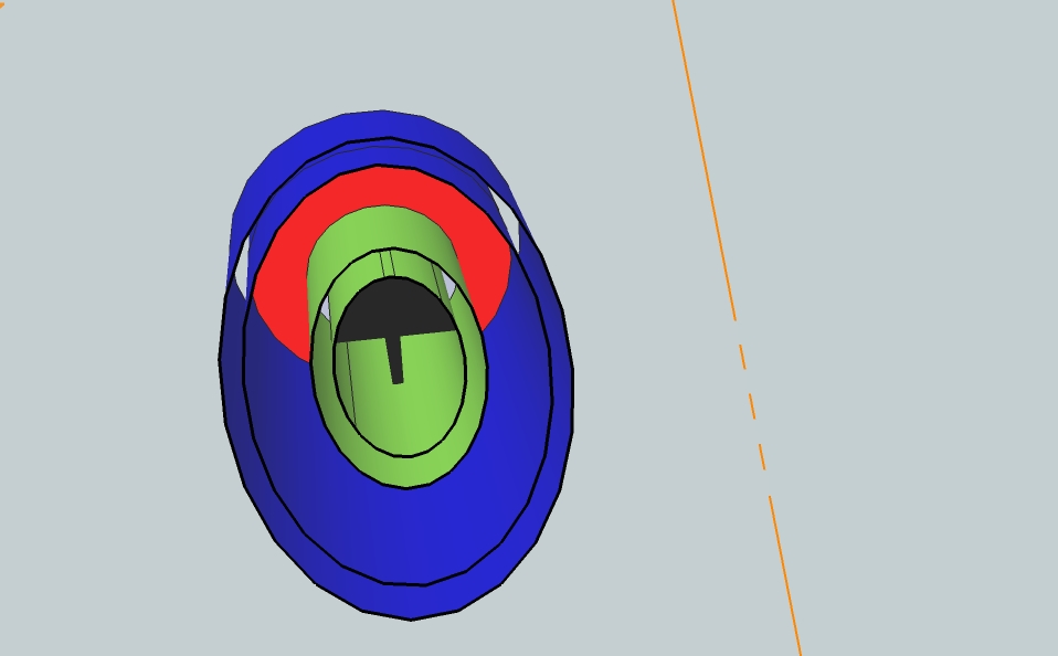

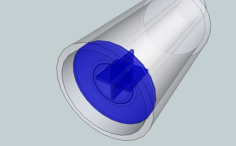

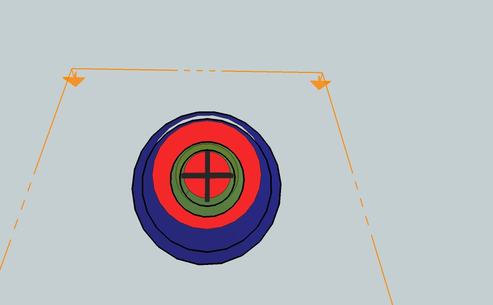

I just had an idea for a compact piston for coaxial cannons that would ride inside the barrel. The sealing face would be attached behind this piston and seal gently against the chamber walls to facilitate valve actuation. Im not sure if it will work but it would be able to reduce pilot volumes by having less area behind the piston. Flow would be slightly reduced. I envision this piston being made of two half lapped pieces of plexiglass epoxied together. Custom plugs for the chamber could also reduce pilot volume.

You could even go so far as to shape the mating edges of the cross piece and the sealing face to an arc to reduce turbulence and help guide the air out the barrel.
Looks interesting, Though I would probably put rubber on the barrel and have the piston made from aluminum or some impact resistant plastic.

- Technician1002
- Posts: 5189
That is a wide ratio piston (large OD to Seat). The problem with them is as the pilot pressure drops the large area opens the pressure while the pilot is at a relatively high pressure. When the chamber begins to vent out the barrel and the chamber drops a little, the pilot pressure will slam it back closed.
The only way to keep one of the wide ratio pistons open is to use a large pilot valve. Otherwise they honk.

Now all you have to work out is the bumper, and of course ensuring that the thin piston won't deform with the abuse it will receive. Not too difficult.

The piston does not nesasarily have to be a wide ratio. This is only the way i drew it. These sizes have no reflection on actual pipes.
What do you think about bouncy ball bumpers? Cut in half and glued to the plug. Would the ball bounce the pistion back into the closed position?
What's wrong with a cup type piston as illustrated here?
It can be just as compact and avoids the awkward shape running in the barrel.
