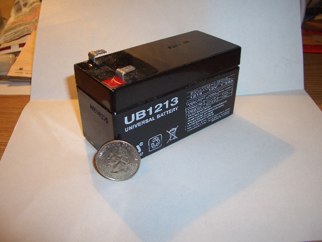

A possibility is a small 12V lead-acid gel battery. For example;
http://www.allelectronics.com/make-a-st ... ERY/1.html
3.8" x 1.7" x 2" (that's pretty small), 1.21 lb.
$10 (+$7 shipping IIRC)
Can be recharged with a car battery recharger (or straight off a running car using jumper cables.)
Take a look at the other 12V batteries at AllElectronics.

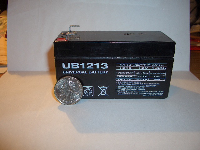

A quick note on batteries. They are rated in Amp Hours. A small 4 amp hour battery can provide 1 amp for 4 hours or about 4 amps for 1 hour or 20 amps for about 12 minutes.
How many shots are you planning and how long does it take to fill your chamber. Battery size matters.
The faster you discharge a battery, the less capacity it has, so on the 20 amp draw, expect less than 10 minutes run time.
The tiny battery in the post above is only 1.3 Amp Hours.. Don't expect it to run a 10 amp compressor very long.
Many NiCad or NIMH batteries have a much higher capacity in a smaller package and can provide high discharge current.

For the math challanged, 2500 mah is 2.5 Amp Hours or about 2wice the capacity of the lead acid battery in the photo. The LiPo is able to provide a higher discharge current than the Lead Acid.
