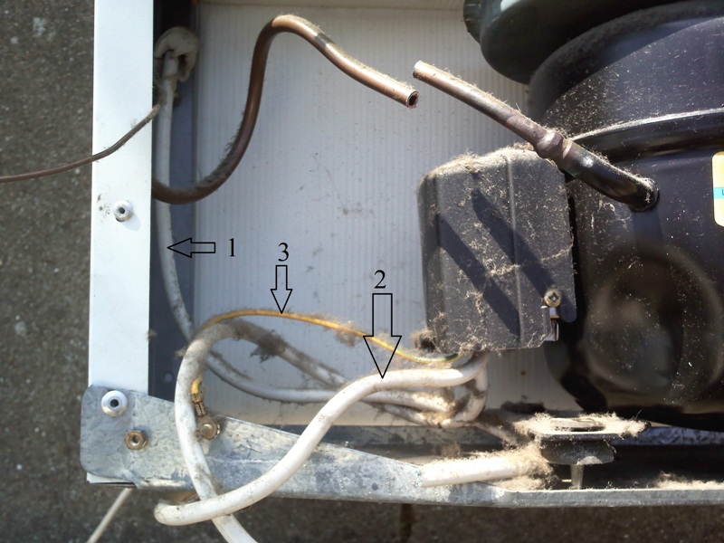

1-wire that goes to the inside of the firdge 2-wire that goes to the base of the firdge 3- wire that connects to the power source

Are there 2 or 3 white cables?
One cable is Power from main.
There may be a cable for the fan power.
There may be a cable for thermostat and door light.

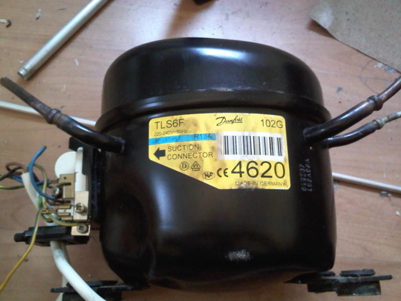

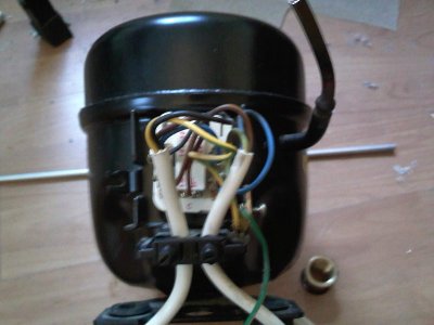

Please post a pictures of:
The whole compresser with both cables showing.
A close up, in focus and without your finger in the way.
If we can see all the cables with colored wires on both loose ends we can explain it better.

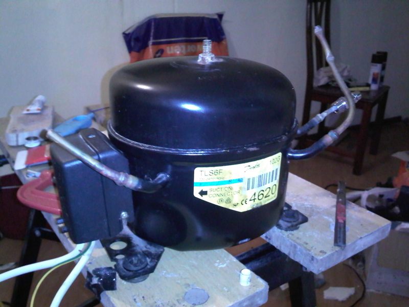

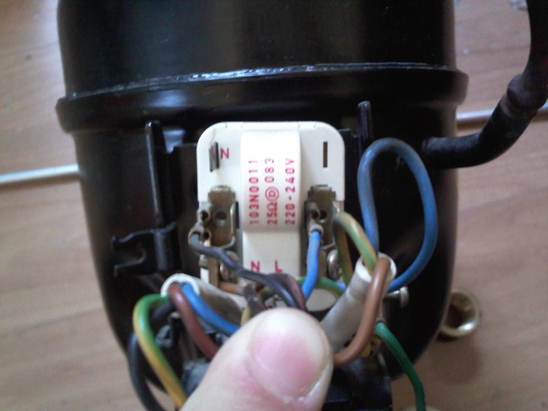

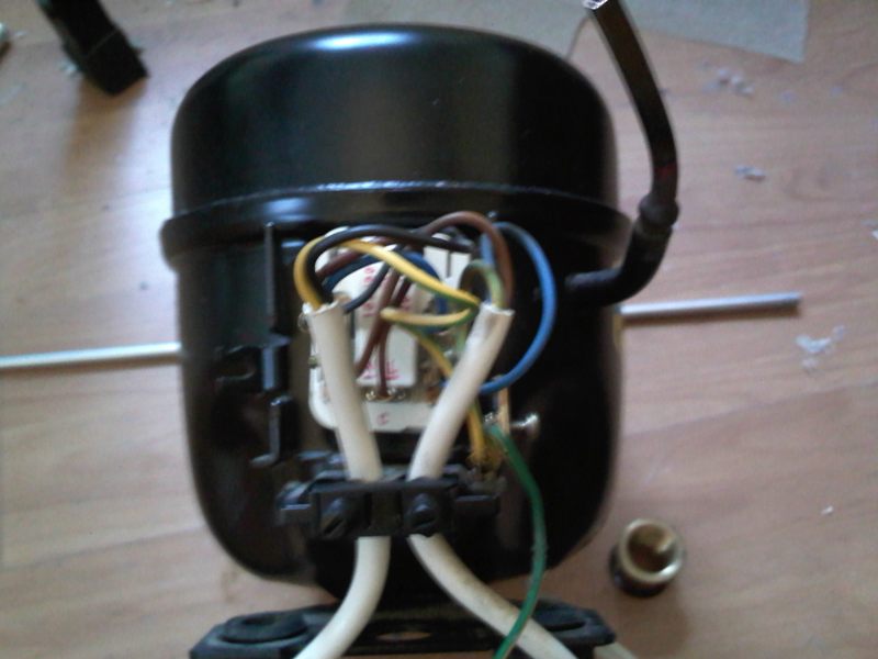

Here are the wires, basiclly I already understand how it was connected, and I think I have find out witch are the termostate wires :)
the compressor
the compressor
the wire that I had cutten when I took out the compressor

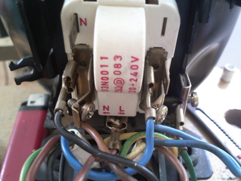

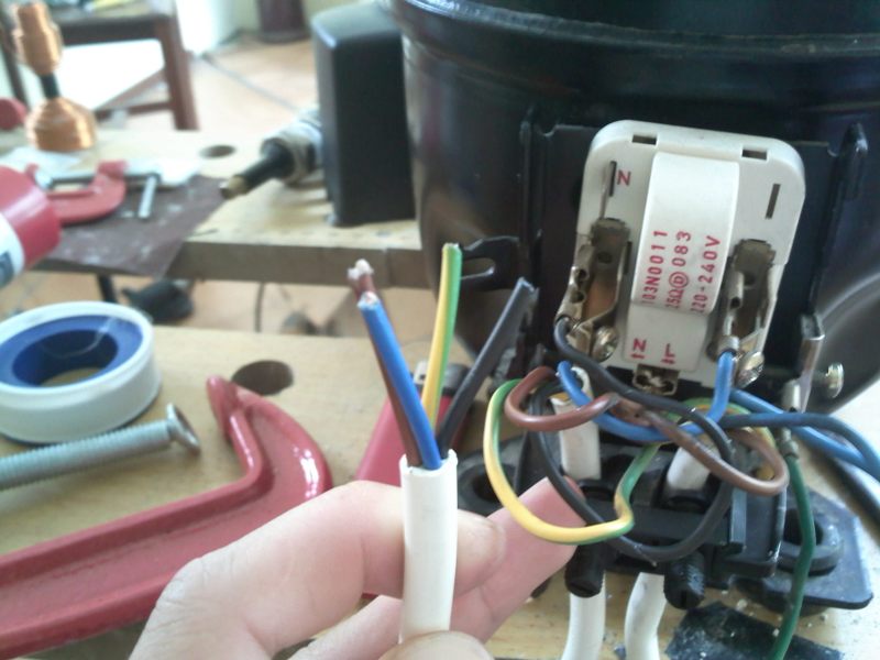

like i said in my post before just pull the adjustment knob out and check the wires that its connected to. But with my slightly educated guess its blue and brown from the from the second pic you just posted BUT only if they used to lead into the fridge.
dewey-1
Posts: 1298
Location: NE Wisconsin USA
Those are cables not a wire that you refer to. Each cable has multiple wires.
Are all wires in there original positions? Meaning you did not move any around?
It is odd to see a Blue wire on the L terminal.
The left most cable has four wires in it:
Black
Brown Thermostat
Blue Thermostat
Yelllow/Green is Earth/Chassis ground
The right most cable has 3 wires in it: (Main power plug)
Brown is Line
Blue is Neutral
Yellow/Green is Earth/Chassis ground
