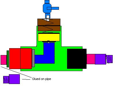

OK here we go. Green is the T, Yellow is the piston, blue is a 1.5" street elbow, gray is a 2.5" to 1.5" bushing, red is a 2.5" coupler, dark green is a 2.5" to 1" bushing, Black is a 3" to 1" bushing, pink is 1" PVC, purple is 1" male threads, brown is a 3" plug, white is a 1" nipple tapped into the plug, light blue is a 1" ball valve, and there should be a schrader sticking out of the side of the plug. Forgot that part. You may have to sand down the 2.5" coupler to make it fit in the 3" T.

If this was for huse spud then you should have PM`d him.

I did but I don't know how to put a pic in PM so I just poseted a topic that he'll find.

thanks man you are a dude.
i should donate some spud bux. :lol:
EDIT: there's 50 spud bux for ya
if i plan to redo stud-zooka i'll make a new chamber and use the 4" pipe form the old chamber for my next project.
i'll then have 2" openings in my chamber instead of 1".
have a 100 more, i'd give you cash if i could this is brilliant!!!

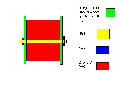

The piston can be anything pretty much. It can be an end cap but I don't know what size would be good because they don't have fittings here bigger than 2". You can also try putting some large gaskets on a bolt and have that in there. Glad to help you.
This is really easy to make and also works.

umm i could just make it like a diaphram, it seems easier. if i make a piston it'll be for a coaxial.
did you think of this yourself? this is quite cool.
you are a spudgun master!
is a gasket a plastic disk? i'm sorry for my ignorance but i've only gotten into this spudgun stuff in the last 4 months plus i don't have a smart adult to help me, i don't know that much.

The piston sealing surface is rubber or neoprene rubber, (wetsuit material).
or anyhting that seals.

Gaskets are like nylon rubber disks that are kind of flexible but hard too. It's not hard to think of stuff when you know how it works.
