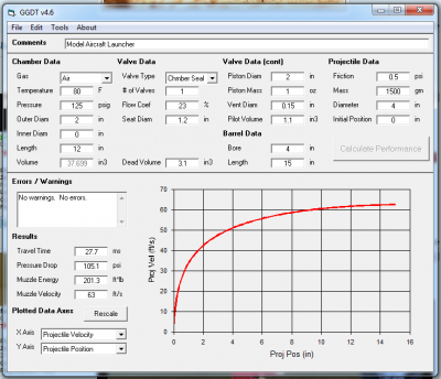

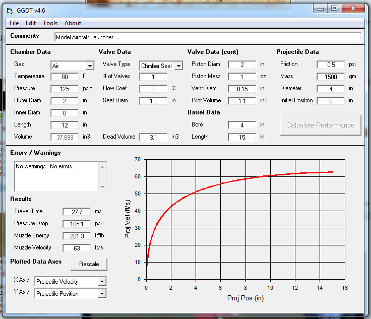

I modeled a launcher for you using GGDT.
I used a 4 inch diameter barrel and 2 inch diameter chamber with a modified one inch sprinkler valve between them.
Using only 125 psi of air and a 15 inch long barrel, and assuming a 200 gram foam sabot for your 1300 gram aircraft, we get a launch velocity of approximately 70 km/h.
I'm assuming you're in France so you'd have to find metric equivalents.
The chamber is relatively small so 125 psi can be reached with a good track pump or if you don't feel like pumping, a paintball bottle with a regulator or a good automotive compressor (avoid the cheap Chinese ones, they struggle even up to 40 psi...) will do the job.
While it gives you the performance you want, note that this configuration is not ideal because the valve is rather small. The best would be to find a bigger one, this will allow you to use lower pressure and a longer barrel, giving more gentle acceleration to the aircraft and making it less likely to be damaged on launch.
