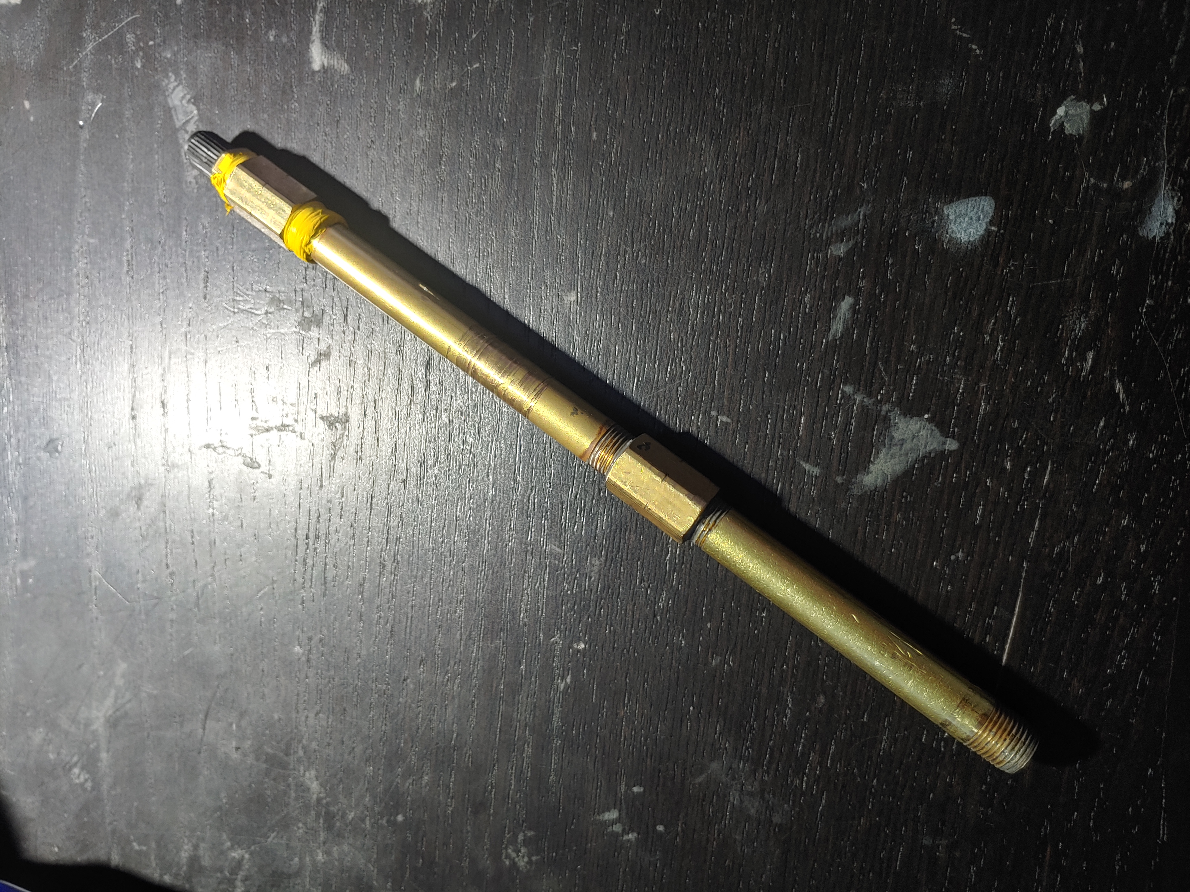

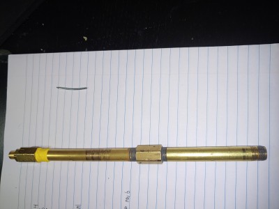

I have finally completed a simple coaxial pengun, yet another copy of a copy of JSR's design from so long ago. I'm very happy with it!
The build is made up of two 1/8" brass pipe nipples coupled together, with an OD 7mm ID 6mm stainless tube epoxied inside. Inside of that tube is the barrel, an OD 4mm ID 3mm stainless tube. The piston is a short section 6mm steel rod with a slice of 1/16" thick rubber epoxied to the top.
This is my third attempt at one of these damn things, mostly owing to struggles getting a proper piston made. Concern that my piston would not work is why this one is built inside of pipe nipples- the valve can come off and the piston can be removed for service.

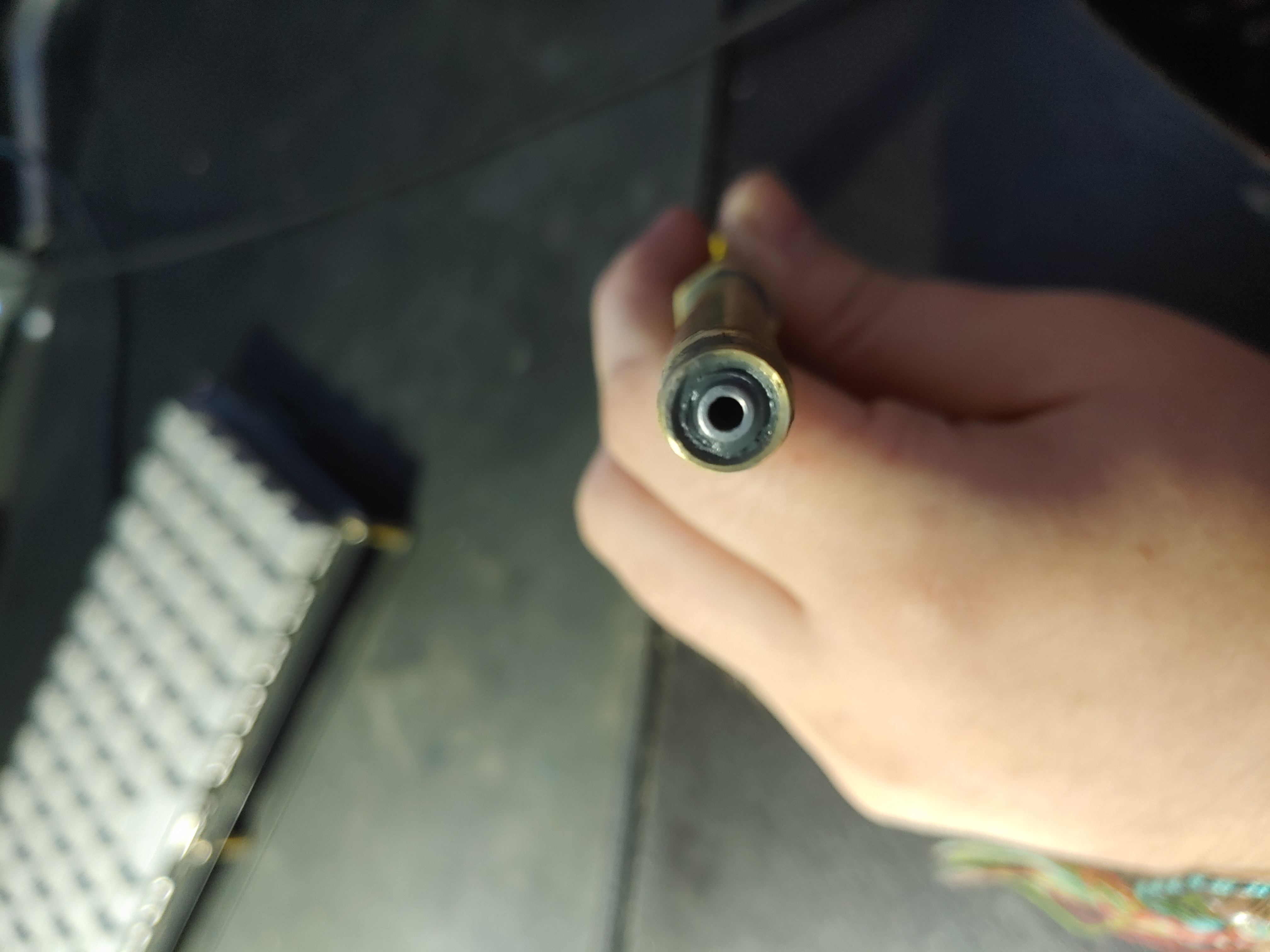

The tube I ordered to be the barrel is supposedly 3mm, but 3mm steel ball bearings do not fit at all. Not even half of the bb will fit inside, so I am thinking it may be 2mm or perhaps 2.5mm. Any way to loosen the barrel, or should I just get new bearings? I would also love to hear other ideas for ammo.

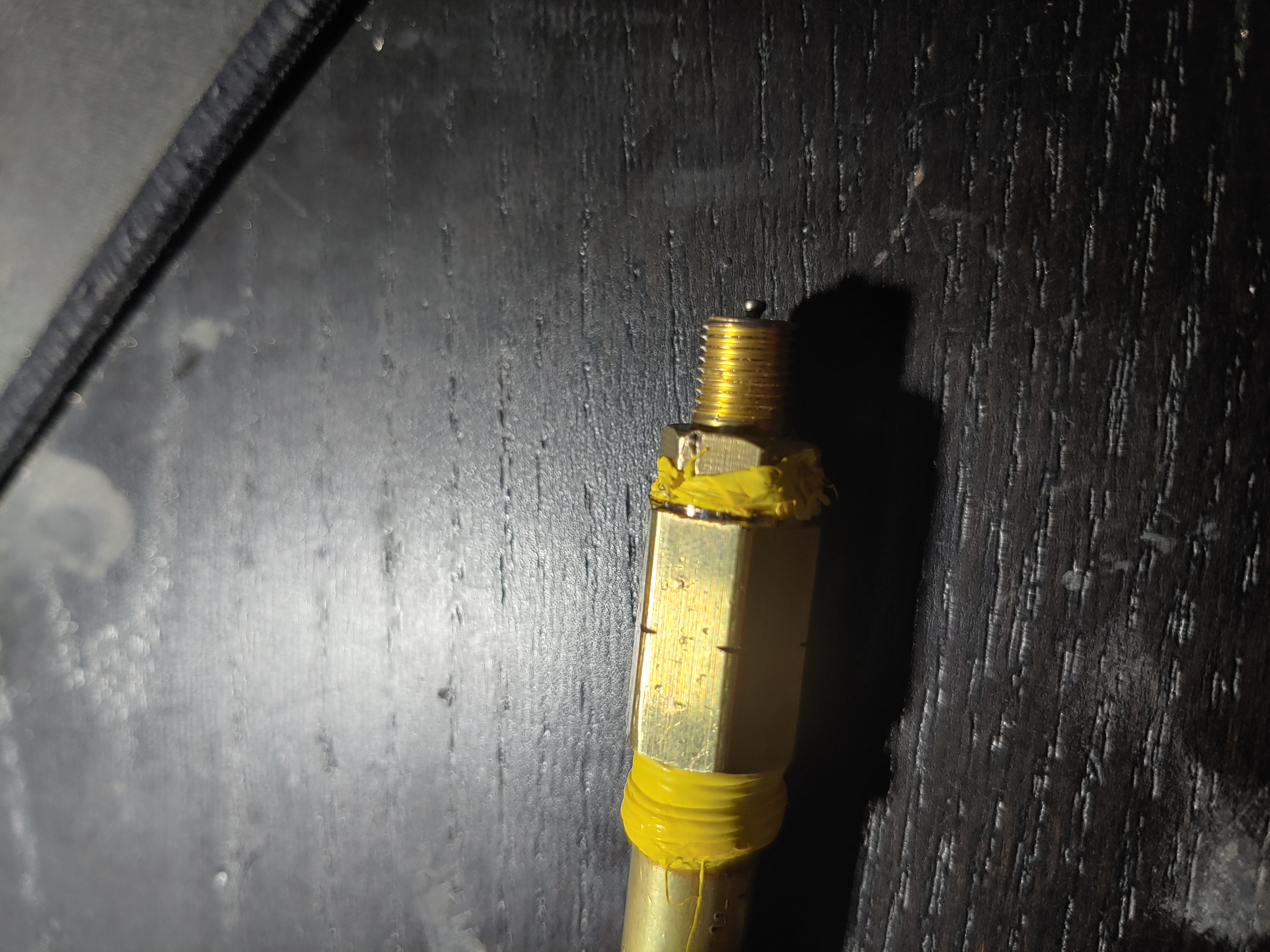

I have been shooting it at 1000psi, but I might step up to 2000psi soon, once I receive some extremely high psi rated Schrader cores I ordered from an aviation supply

I would just get the right sized bearings, small nails with their heads cut off also work as PracticallySane suggested but only for very short ranges as they start to tumble.Any way to loosen the barrel, or should I just get new bearings?

I disassembled it and took the piston out and I must say, I am glad I made this thing serviceable because the sealing face is already looking pretty rough. Let's see how long it goes before I must replace it...

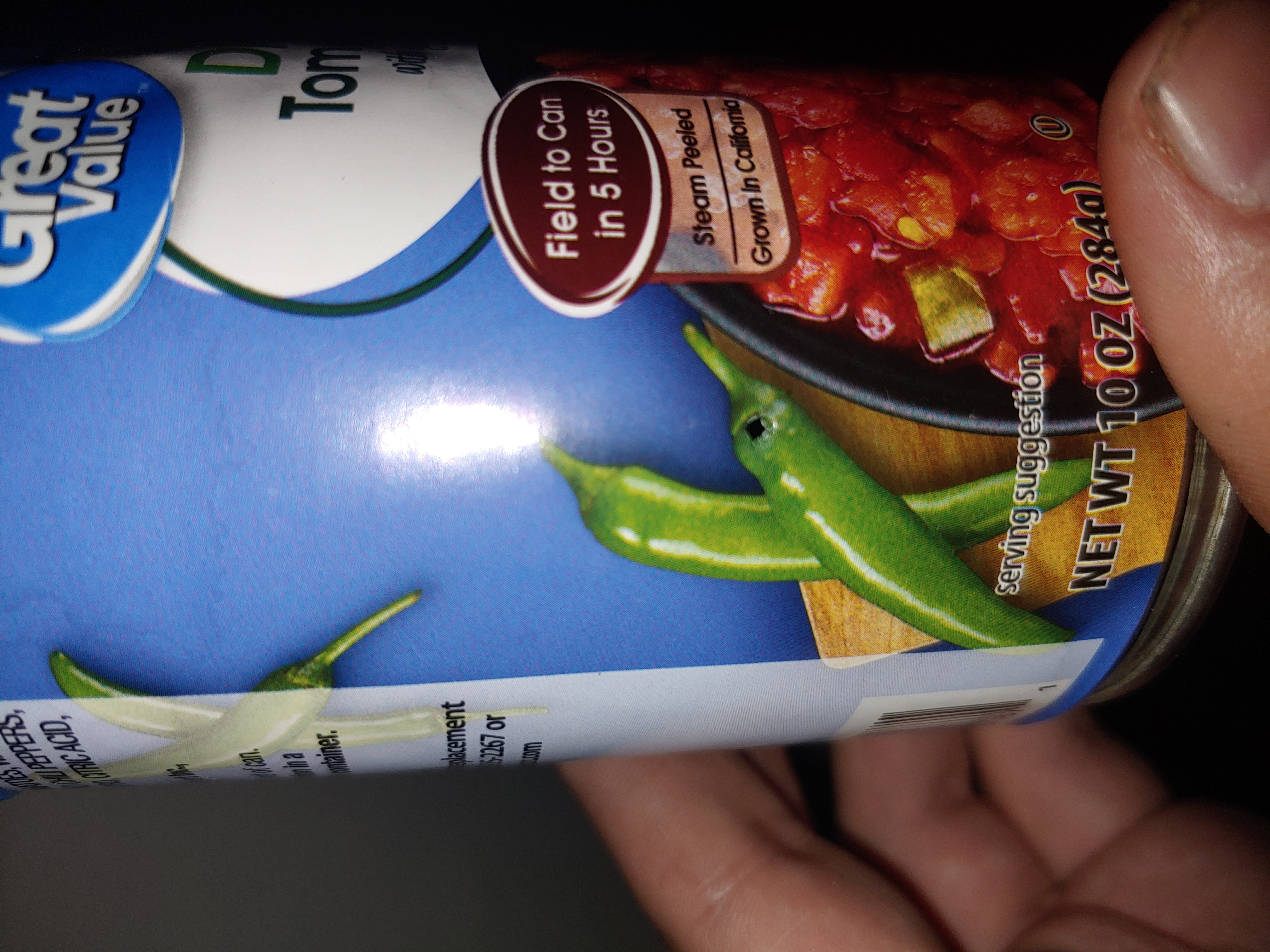

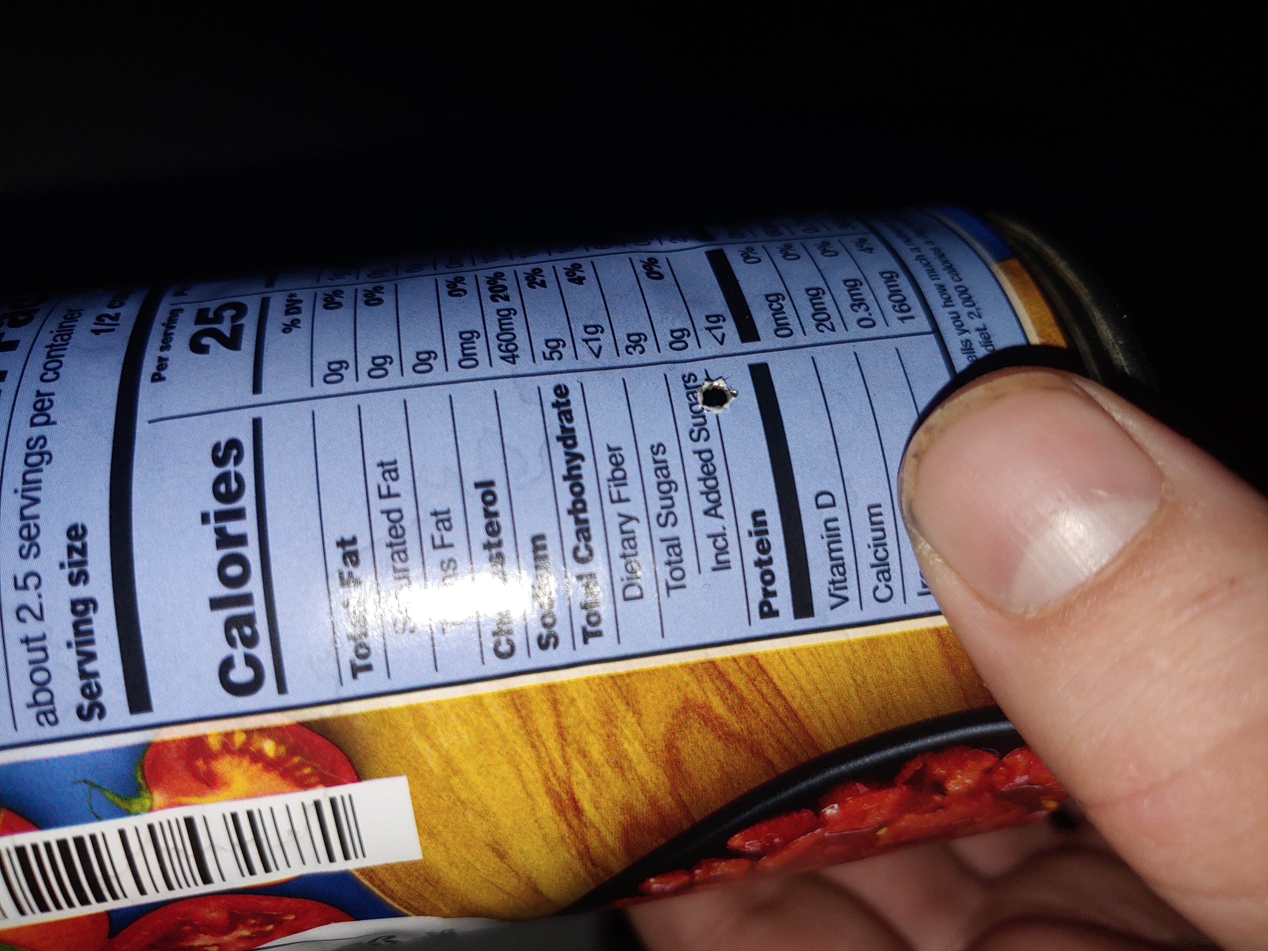

I shot a tin can with a nail using the pen gun @ 1000psi. I was quite happy with the results...
When I shot it, I saw orange sparks fly out, and it smelt like smoke... Is that normal?? Lol.

That joke is literally as old as the first pen gun
Hmmm... from the pen itself? Or the target?SloppyJoeES wrote: Fri Dec 18, 2020 7:37 pmWhen I shot it, I saw orange sparks fly out, and it smelt like smoke... Is that normal?? Lol.
Could it be that you had some lubricant in the barrel that ignited from the sudden compression?

It was from the target for sure. Maybe just from the steel hitting steel. I did lubricate the piston quite heavily with silicone grease, but I don't think that's flammable.jackssmirkingrevenge wrote: Sat Dec 19, 2020 10:30 am Hmmm... from the pen itself? Or the target?
I have shot the same can a few more times since then and have not gotten the same sparks, which I find somewhat disappointing because I thought it was pretty cool.
Oh in that case, perfectly normal when punching through steel fast enough

If you want to get a bit of sparks and smoke, add a small drop of oil, like spring-loaded airguns do, with the dieseling effect. Your work was excellent, I'm thinking of building one like me too.SloppyJoeES wrote: Sat Dec 19, 2020 5:31 pmIt was from the target for sure. Maybe just from the steel hitting steel. I did lubricate the piston quite heavily with silicone grease, but I don't think that's flammable.jackssmirkingrevenge wrote: Sat Dec 19, 2020 10:30 am Hmmm... from the pen itself? Or the target?
