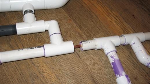

So the valve you can see in the second picture leaks along with the two others inside. I used the zero semi auto valve idea from nerfhaven.com which probably wasn't a good idea. Or I should have tested it first somehow before gluing it together. I'll take it a little slower next time.

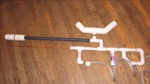

What should I do now though. I was thinking maybe I could use the stock but throw out the piece on front. The barrel and the hopper are threaded so I can use those again too. Maybe I should just use two sprinkler valves and a temporary chamber. I'm not familiar with sprinkler valves so I don't know how you reset them but it's a thought.
Any thoughts?

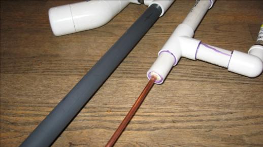

Ok read the page, think I got it, where’s it leaking at? Take one of your pictures and label where the air’s going in and out, where the valve is, although I think I know, etc.

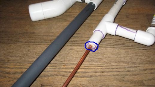

Air leaks out between the copper tubing and the CPVC endcap. I don't think they make the O-rings nerfhaven says you should use but I dunno. Anyway I got two different types of O-rings one with OD 7/16" x 1/4" ID to create the seal (that doesn't work) and another that was just a little bigger to fit inside the vinyl tubing. I just put both o-rings in there hoping the bigger one would hold the smaller one in place (make sense?).
I think it is a pretty good design except I'm not sure the holes in the copper tubing let air out fast enough.
- judgment_arms
- Posts: 1272
Hummm…can you take out the brass tube? If you can remove it and pick out the O-ring, then go and find the right one. Or if you’ve looked high and low and still can’t find one get a package of “gasket material”, it look’s red around these parts, you can get it at the home-cheapo, and I’ve seen ’em at the ACE. Well you’re at the hardware get another CPVC end cap as a pattern, cut enough disks so that stacked to gather they are at least as thick as the original O-ring preferably just a faction thicker. Now find the exact center of those disks and take a scrap of ¼” brass tubing and place a disk on a piece of scrap wood, center the piece of tubing and hit it with a hammer until you get a perfectly punched hole, repeat that until all the rubber disks are done, now stick those “gasket” disks in the slot the valve were the O-ring was, put the brass tubing back in and your done. No guarantees that it’ll work, I think it will but in case it doesn’t; now you can’t say I didn’t warn you.
