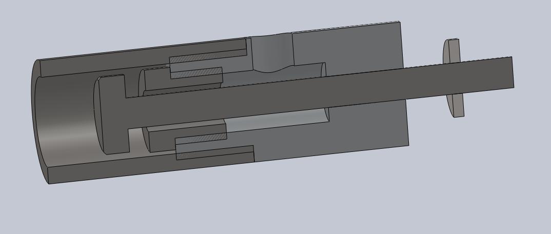

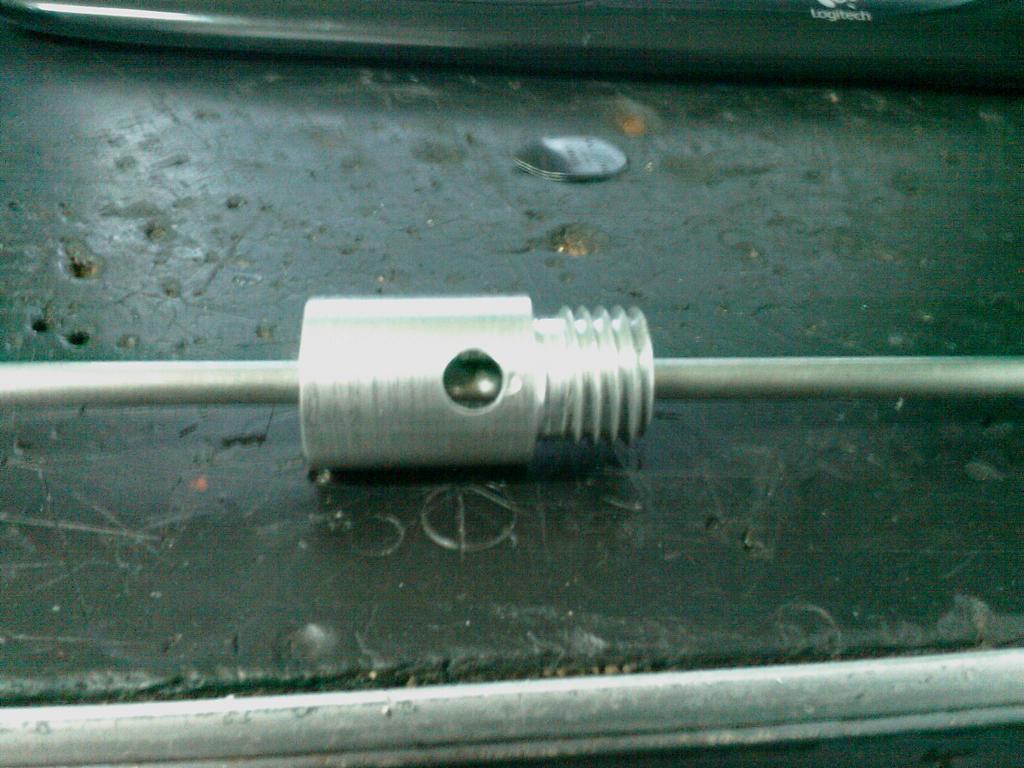

The design and actual work done on my hammer valve pnaumatic.
Comments are appreciated, it will run off of 200 ish bar by the way, so hooraay for me, if I survive filling it up.
The design of the hammer valve
The back of the hammer valve

Looking very good! :) Nice job on the threads too.
Why did you decide to place the spring externally?(Or is that not a spring retainer on the valve stem?)

Very nice, I have always liked custom hammer valves. I have a design floating around my file drawer with a design for a 'reversed' hammer valve that is part of the bolt, rather than the breech.

Nice. Will this be used to pilot a gun?
Could do semi-auto if you used a modded QEV.

Gippeto wrote:Looking very good! :) Nice job on the threads too.
It is a spring retainer, it will be adjustable using a threaded connection, so it also kind of acts as a regulator ish device.
This is just a test piece, stainless steel comming up today or tommorow. : )
psycix wrote:Nice. Will this be used to pilot a gun?
Yes it'd be used to pilot a pilot gun for my railgun. *confuzzlewuzzle*
