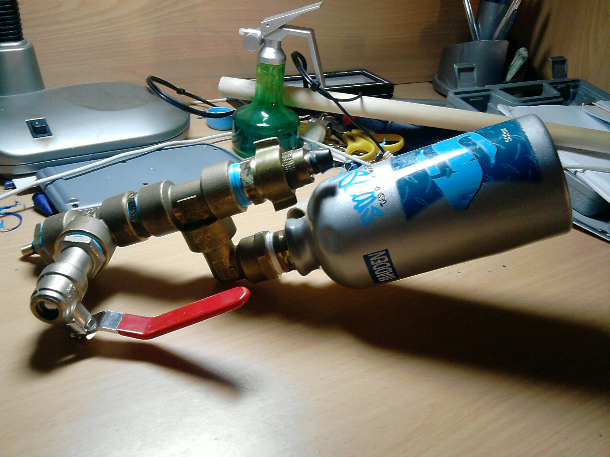

Hey guys any idea what kind of pressures these kind of drink bottles can take?

Never tried it. I would recommend hydrostatic testing to find out. Fill one completely full of water and test under pressure at 150% to 200% of the max you intend to use it. For a 100 PSI launcher the test pressure should be 150-200 PSI. Since they are much thinner than pressure stuff, I would think the rating would be lower than that of an spray can due to the flat bottom. Maybe 60 PSI tops.jmadden91 wrote:Hey guys any idea what kind of pressures these kind of drink bottles can take?

Awesome thanks heaps mate. I dont have the equipment to test it. But I have just tried firing with it on. I dont have to worry about the pressure yet cause my gun leaks like a sieve. I do have an empty fire extinguisher downstairs that i think i will put on instead. I just thought it could be a decent cheap option.

No special equipment needed. Fill the water bottle with water and install it. Pressurize as normal, higher if possible. Operate it below the test pressure with a safety margin. For example my ABS test cannon (the apple cannon) is tested to 85 PSI and operated in the 30 to 60 PSI range.jmadden91 wrote:Awesome thanks heaps mate. I dont have the equipment to test it. But I have just tried firing with it on. I dont have to worry about the pressure yet cause my gun leaks like a sieve. I do have an empty fire extinguisher downstairs that i think i will put on instead. I just thought it could be a decent cheap option.

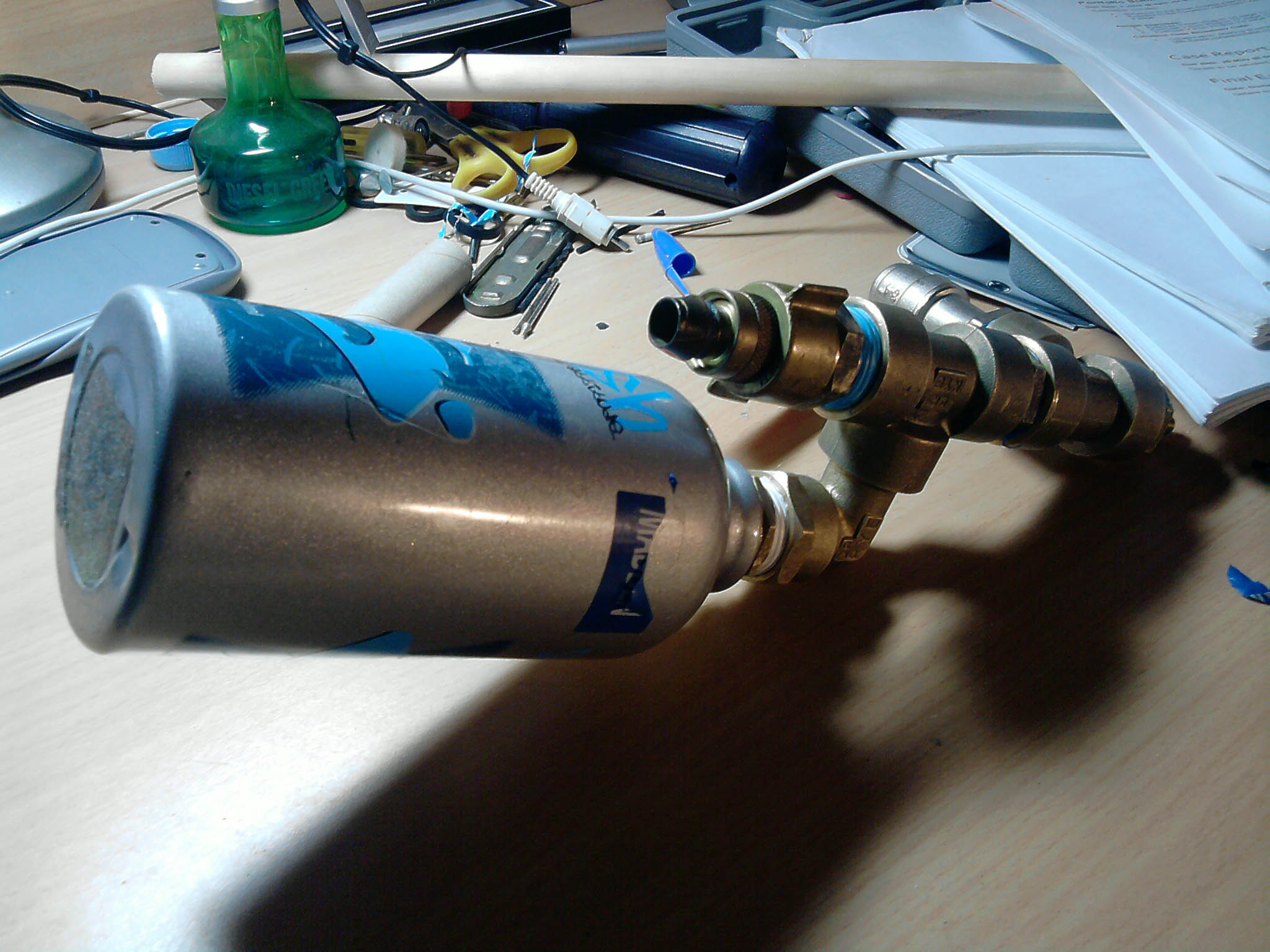

I have tested a french bottle (like the one biopyro mentioned) to 21bar.
The flat bottom will become convex around that pressure.
I tested the bottle with air pressure but filled with over 90% water, even though the air will expand pushing water, there is only a few cubic centimeters instead of over a litre of high pressure air. So I do consider this to be safer in my situation, allthough there are other things to consider, like the fact that the bottle could become a hard, high inertia, high powered water rocket.
