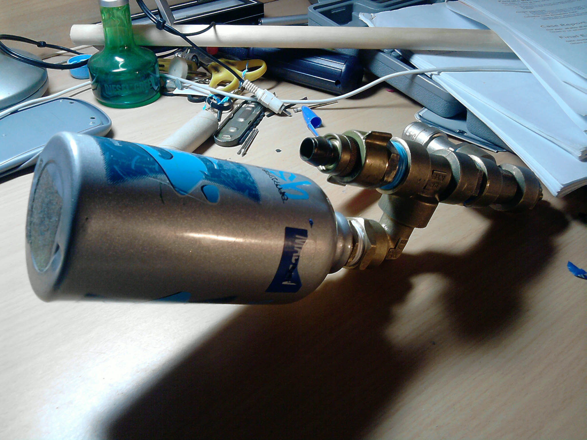

Hey guys any idea what kind of pressures these kind of drink bottles can take?
Cheers

jmadden91 wrote:Hey guys any idea what kind of pressures these kind of drink bottles can take?
Cheers
Never tried it. I would recommend hydrostatic testing to find out. Fill one completely full of water and test under pressure at 150% to 200% of the max you intend to use it. For a 100 PSI launcher the test pressure should be 150-200 PSI. Since they are much thinner than pressure stuff, I would think the rating would be lower than that of an spray can due to the flat bottom. Maybe 60 PSI tops.

Awesome thanks heaps mate. I dont have the equipment to test it. But I have just tried firing with it on. I dont have to worry about the pressure yet cause my gun leaks like a sieve. I do have an empty fire extinguisher downstairs that i think i will put on instead. I just thought it could be a decent cheap option.
jmadden91 wrote:Awesome thanks heaps mate. I dont have the equipment to test it. But I have just tried firing with it on. I dont have to worry about the pressure yet cause my gun leaks like a sieve. I do have an empty fire extinguisher downstairs that i think i will put on instead. I just thought it could be a decent cheap option.
No special equipment needed. Fill the water bottle with water and install it. Pressurize as normal, higher if possible. Operate it below the test pressure with a safety margin. For example my ABS test cannon (the apple cannon) is tested to 85 PSI and operated in the 30 to 60 PSI range.

They use them quite a lot in france. I think this guy
http://www.spudfiles.com/forums/d4-fren ... 17748.html
said up to 10bar.

Oh awesome. Are you sure they aren't C02 Bottles though?

The water doesn't store much energy because it's essentially incompressible. Gases do store a lot of energy and consequently if a burst happens it can be dangerous.
I'd suggest against using something designed for drinks and for using something designed to be pressurized. The bottom of the container likely isn't designed to handle the stress well. That's not to say that it won't handle any stress, just that it likely is a poor choice.
Aluminum cylinders designed to be pressurized are cheap. I have one by this company: http://www.catalinacylinders.com/lp.html
The 600 psi burst pressure ones have a rating of 240 psi, the 1250 psi burst pressure tanks have a rating of 500 psi, and the 1440 psi burst pressure tanks have a rating of 576 psi.
Give them a call if you want to order one.

Water doesn't compress. As a result when hydrostatic testing tanks, they may split and leak but don't explode because it doesn't expand when released. Try it with ballons. Pop an air filled ballon. It's noisy. Now pop a water balloon. The splat is from the rubber, not the release of compressed air. It's not loud. A metal tank failing with air can be very dangerous. A failing metal tank of water won't throw stuff far.

I have tested a french bottle (like the one biopyro mentioned) to 21bar.
The flat bottom will become convex around that pressure.
I tested the bottle with air pressure but filled with over 90% water, even though the air will expand pushing water, there is only a few cubic centimeters instead of over a litre of high pressure air. So I do consider this to be safer in my situation, allthough there are other things to consider, like the fact that the bottle could become a hard, high inertia, high powered water rocket.
