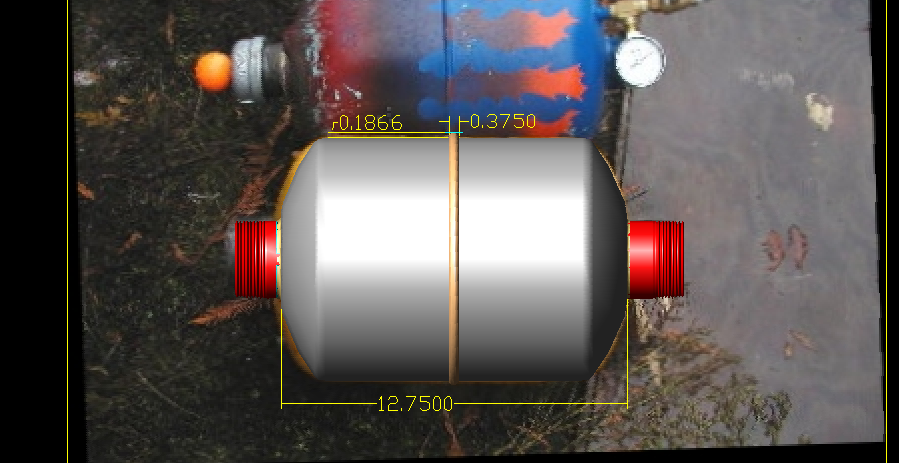

Here is the ported piston sleeve.
QDV-2.5 x 16-9/16 ported piston sleeve. Port length 1.5". Rib width .50"

@Tech;
Here is preliminary tank and piston sleeve 3D model.
Need weld height and width on tank seam.
Otherwise I think the tank is complete.
Left side of tank has the ported sleeve.
Will need sleeve location.
Ready to do the piston next.
dewey-1 wrote:@Tech;
Sweet drawing. The weld bead on the waist of the tank is 0.060 inch tall and 0.305 wide.
