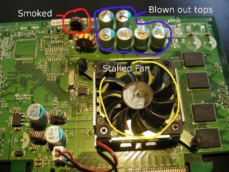

How do you plan to put the smoke back into those Radial Leaded Electrolytic Capacitors?
I have been trying to figure that out for over 45 years!

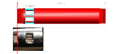

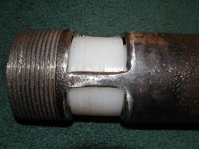

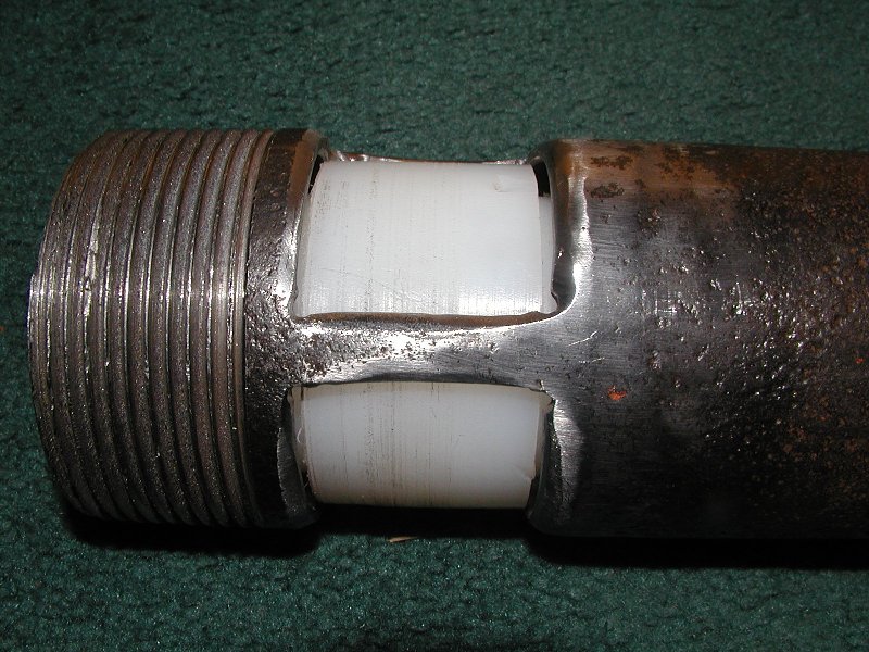

Here is the ported piston sleeve.

This looks like a very promising high performance valve!

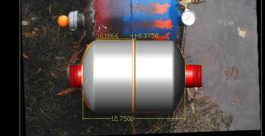

I don't know if it can even be called a valve. Its like, the barrel is closed and then suddenly its just open as hell. It look like this thing is going to shoot really hard.

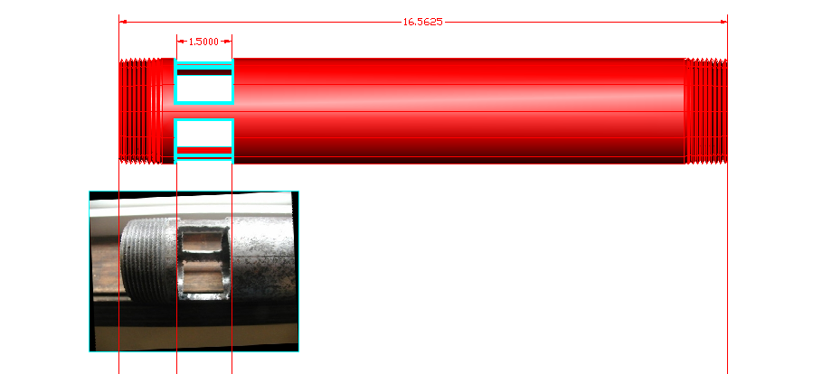

Here is preliminary tank and piston sleeve 3D model.
Need weld height and width on tank seam.
Otherwise I think the tank is complete.
Left side of tank has the ported sleeve.
Will need sleeve location.
Ready to do the piston next.
- Technician1002
- Posts: 5189
Sweet drawing. The weld bead on the waist of the tank is 0.060 inch tall and 0.305 wide.dewey-1 wrote:@Tech;

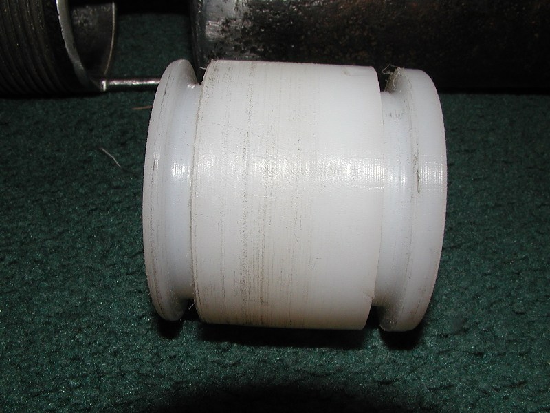

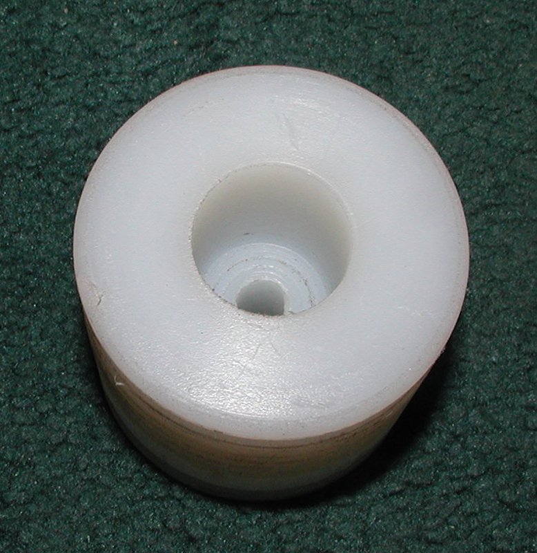

The piston is now 2.33 inches long. Diameter is 2.46 in diameter. The piston is now larger around than it is long. O ring grooves are 0.230 inches wide. They are 0.224 inches deep. The piston body between the grooves is 1.45 inches long. The rear shoulder is 0.255 thick. The front one is 0.161. The front recess is 0.98 inches in diameter and 1.294 inches deep. The rod hole in the back is 0.365 in diameter.

Which O-ring do plan on using? A 330 or 331 number?
I see a potential air leak because the port is 1.5" and piston is 1.45".
Maybe I am just looking at it wrong from a pressurized standpoint.
I can show drawing of concerned area if you would like.

I have no idea on the o ring part number. It is the 2.5 inch ring in the grab bins at my local hardware store. Is there a dimension I can measure to identify which this is?dewey-1 wrote:@Tech; Thanks for dimensions.
The o rings do show some inside the centre area, but the edge of them do ride on metal and when the cannon is under pressure the rings do move away from the centre of the piston. It this leakage prevents filling, I may have to make another piston with a tiny bit more length. This was accidental as the slippery piston started creeping out of the lathe chuck as I was cutting grooves. This placed the grooves slightly closer together than I intended. I think it will work. In the worst case, I'll just make another piston.
UHMW is slippery stuff and difficult to secure in a lathe. If I turn another piston, I'm going to bolt it to a piece of round stock so it can't creep in the chuck.

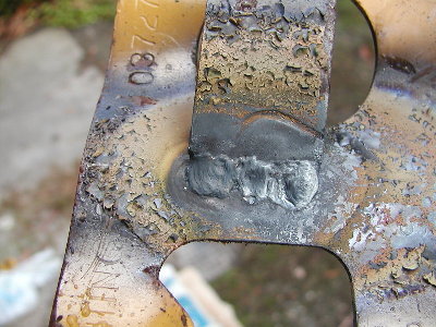

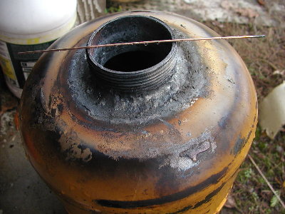

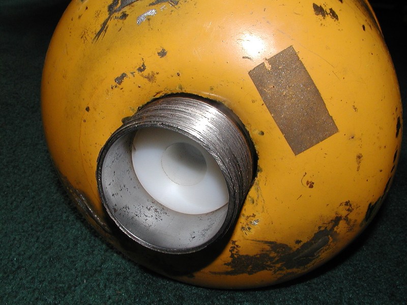

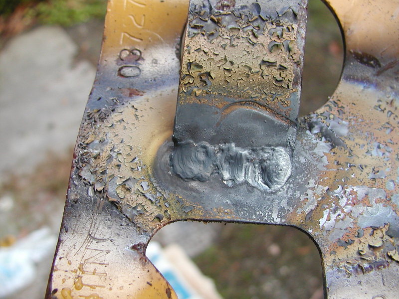

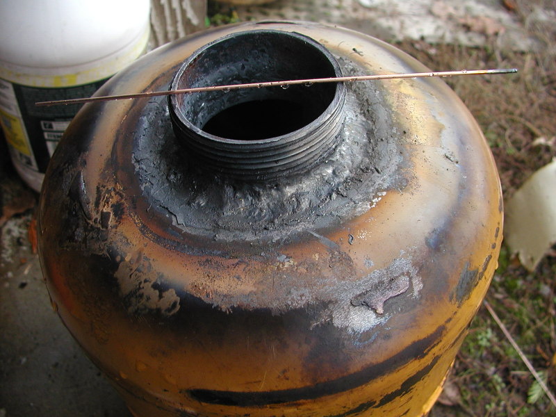

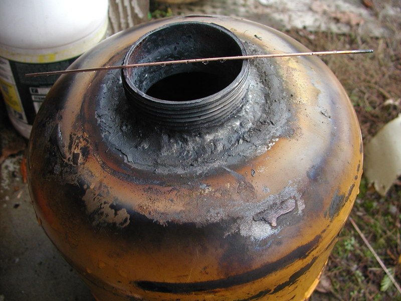

Onto this weeks update, I got the valve welded in. It took me a little time because I am so out of practice welding (haven't done any in a decade). I selected a tip size to do the job and test welded a couple of the tank scraps together. It went well with good penetration of both base metals and a good fill. My hands were not too steady in the windy chilly weather so I don't have the pretty bead the professionals do.
I proceeded to start on the tank and ran into a problem. The tip was a size too small for the thicker pipe and I wasn't getting penetration on the pipe (would have leaked badly) so I went to get the next size larger. My second hand torch does not have that size, so I went up two sizes and proceeded to weld. It worked well but the puddle was too large and I melted through the tank twice welding it. I was able to close the holes fine as I filled in the valley (one of the reasons for it) The larger flame and puddle size did tend to remove the threads near the weld. An arc weld instead of the torch would have been a better choice. Anyway, it is together. I need to remove the scale and re polish the valve (why I wasn't worried about small pits, the scale will bring the exposed metal down to even it out. After the final polish, it should be in good shape.
Lessons learned, Too small of a tip is bad, so is too large of a tip. When flame welding near threads, the thin edges quickly melt off. I would have been better off to braze this and not melt the threads or burn holes in the tank.
On a safety note, the tank did release enough oil vapors to catch fire. I did have a flame dancing on the pipe while I was welding. The exhaust from the torch going in the tank purged the oxygen from the tank as I started so I never did get an explosion. An arc weld would have most likely have gone boom if a shield gas was not used. Don't arc weld a used propane tank without using something to prevent the build up of an explosive mixture. Heating the metal does release combustible fumes.
