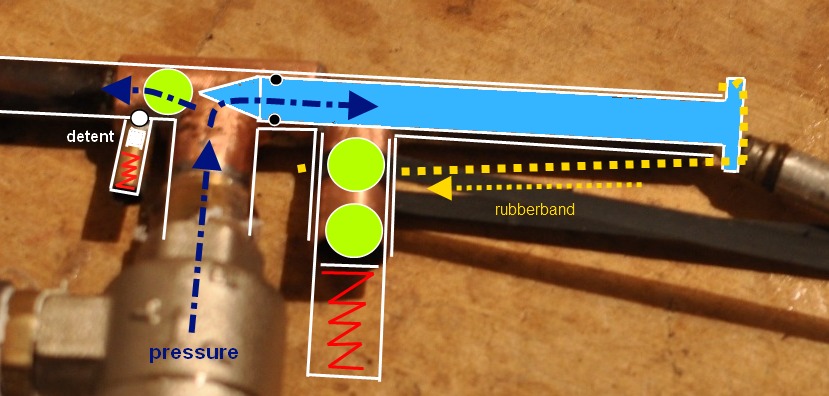

Thank you for your ideas for slowing down the bolt, but I have to admit that I don't really understand them.
Here is a diagram of the current blowback (I told you it's nothing fancy JSR...), feel free to add your idea's into it.
And Poland_Spud, the return stroke is not the problem, because the mag-port is already open at this point.
nature-boy wrote:Here is a diagram of the current blowback (I told you it's nothing fancy JSR...), feel free to add your idea's into it.
Seems I'm of the same mind, but my idea was to eliminate the whole QEV/DCV setup by using an airtight o-ring detent which would remove the need for a fast valve.

jackssmirkingrevenge wrote:my idea was to eliminate the whole QEV/DCV setup by using an airtight o-ring detent which would remove the need for a fast valve.
I even thought about using a o-ringed-bolt for the valve AND the loading mech. ...in fact that looks very similar to yours, only thing I have the seals on the bolt, and it would be semi-auto, yours full-auto.
(you would have to bleed air trough a pinhole into the chamber for it to work).
...ou..I forgot the manual-valve-actuator-rod in the diagramm

Is the thin plastic pneumatic-tube/hose going to your air-cylinder enough flow-restriction or did you additionally slowed down the cylinder with a extra-valve in that line?
al-xg wrote:What you could do is use a forward sliding blow-through bolt instead. ... Or even have the whole barrel move back.
Yeah I thought about it. In that configuration only the pressure in the cylinder will have an effect on the cylinder's spring-driven back-movement, causing it to move back later. The air-cylinder-moving-barrel was done by PVC ARSENAL 17 in his "RSP-Skeleton" if I remember right. (I just noticed that the pictures in his thread are not working anymore, so I can't be sure.)
Another option I came up with would be to have a locked breech, where the loading bolt is separated from the cylinder-piton.
The loading bolt would be locked until the cylinder-piston moves back, unlocks the bolt and pulls it back.
That would have the same effect of the barrel-pressure not playing a role anymore in the forces that act onto the breech.
I even drew a diagram of a locked breech, that could be done with the limited tools I have at hand, but it would definitely be fiddly, and I'm not sure if it's worth it.
yeah probably it does restrict the flow. Not that it is needed...
The air cylinder is connected to the chamber. You have to vent the chamber first to vent the air cylinder. It takes about 9ms for the bb to leave the barrel. the moment it leaves the barrel the chamber pressure is still greater than 50% of original pressure. Which means that the pressure in the air cylinder is even higher
I don't have a high speed camera so I can't check it but I guess that the air cylinder doesn't move at all for the first 15 - 50 ms.
