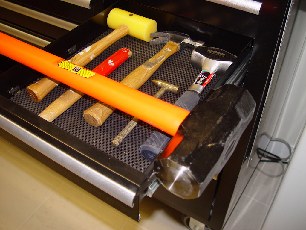

bigger the hammer!
I do have different hammers to solve different kinds of problems ;)

problem solvers... :D i have some too. 1kg,1.5kg,2kg,4kg...
