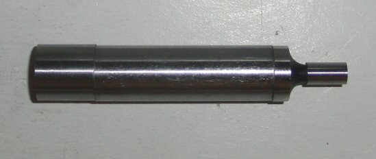

I will use an edge finder, but as you don't have any... you'll need a rod with precise dimensions that you can put on the chuck and use instead.

I figured it might be useful :)
Still has to go in the chuck though, doesn't fit in the mill holder.
edit: prepare to be dramatically less impressed, it doesn't fit in the chuck either!

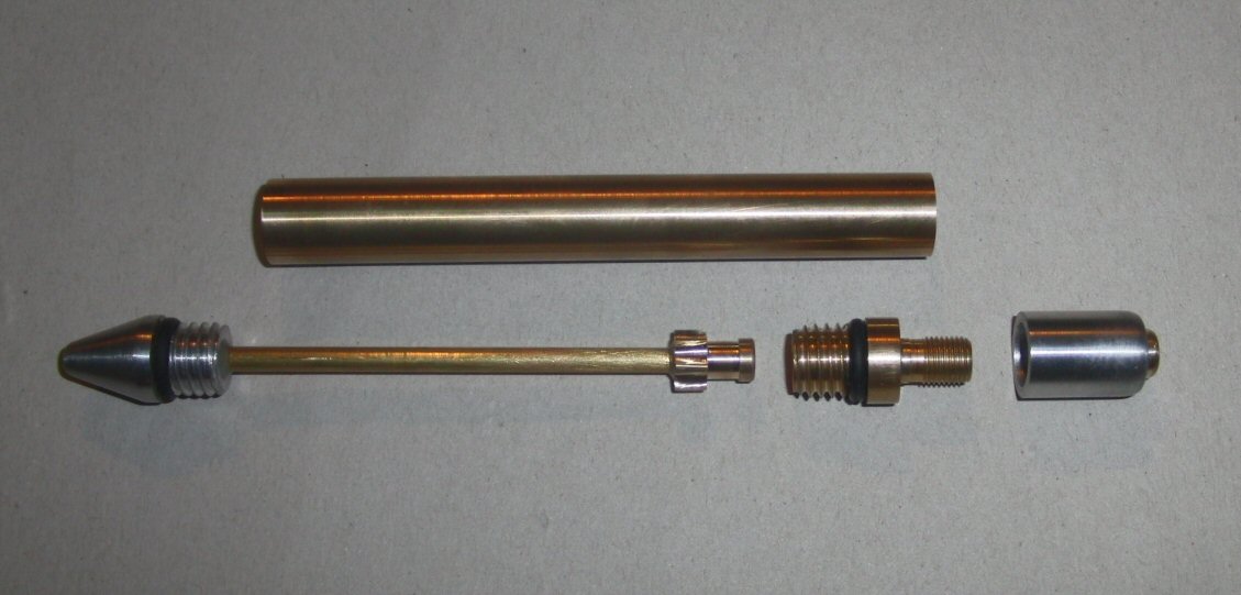

Here's the second part of Step 9: The Barrel support
[YouTube][/YouTube]
Yeah... it's a 3/8" chuck... so sad... :?

Edit, Hey jack, I couldn't resist, but if the edge finder does not fit in anything, might I suggest duct tape? :lol: I couldn't resist! And here, I will get this finished for you: :roll:

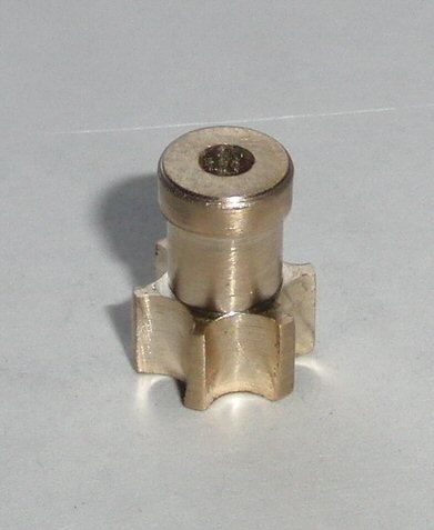

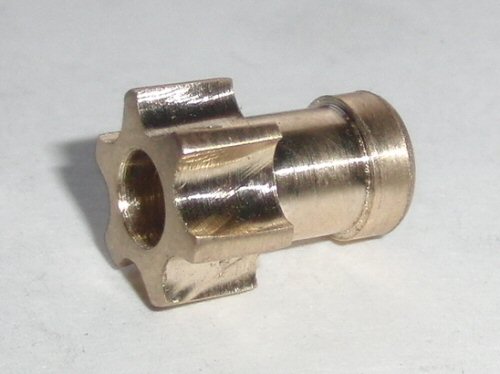

Some finishing on the parts, flats and... dimples! :D
The barrel is just a piece of brass tubing. Look at the plan, first message.

Don't try to turn the edgefinder down with your lathe. It's probably hardened, and runout from your (lathe) chuck would be an issue. Try grabbing the small end of the edge finder with the drill chuck.
If that doesn't work, Chuck up an endmill (in an EM holder or collet, NOT the drill chuck), and load some oversized stock for the spacer. Spin the mill up to a quiet speed, and slowly bring the work in. Once you hear it cutting, the spindle's center is the tool's radius from the edge. Once you're done milling, put it on the lathe, and take off as much as you need from the OD to make it fit. That will remove any marks you made from centering the part on the mill (not that anyone would see them anyway). If you were ambitious, you could use that mark as part of one of the slots, but you'd have to turn the rotary table to center it on the Y axis. You can set the Z axis with the quill using the same method, but it's not necessary for this part; you're not milling to depth.
That's worked well enough for me; I still don't own an edge finder.
Also, I don't think you need to turn the head. You should be able to line up the centerfinder (or EM) by eye (possibly with the help of a shim) on one of the axis, get contact, with the second, then back off and approach the part with one axis while sweeping past it with the other. Perhaps I should make a video...

That would be of interest :) I ordered another edge finder in the meantime.
Part done, but I don't seem to have managed the same finish with the mill as LeMaudit, though I'm quite sure I repeated the same cutting operations... any ideas?
Ah well, time to get the Araldite out and make this thing fire :D
edit: barrel connected and cuting, low pressure testing in a couple of hours :)
edit II: sneaked a quick 75 psi test, no leaks and it worked great! More testing later :D
functionally almost complete :D
