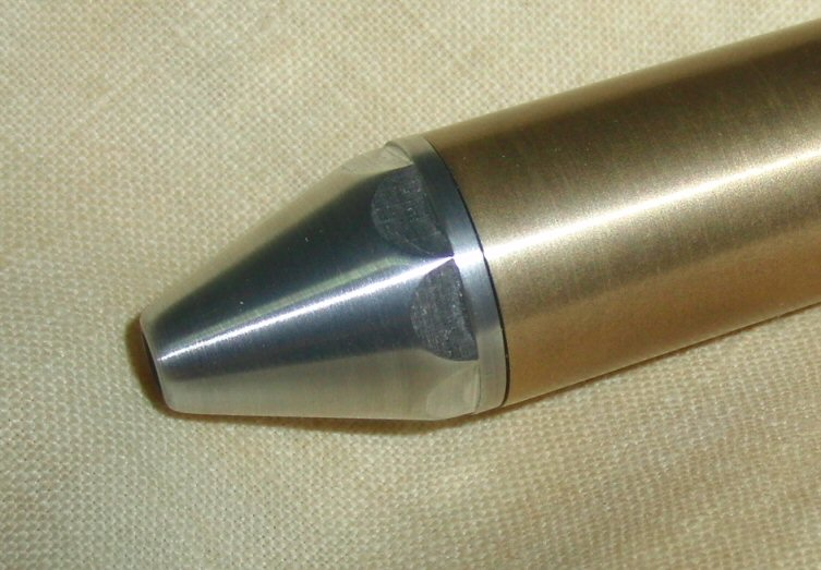

LeMaudit;
What is the flange height on the nose piece? 1 mm maybe?
Also ball cutter radius?
Would cut depth be now .65 not .30 as shown in picture?
Updating 3D model for you!
Why did you not do the same thing on the valve end?
LeMaudit
Posts: 665
I knew this little change would attract you dewey-1 :lol:
Thanks for taking care of updating the 3D, I didn't want to bother for mere details :wink:
Damn... that means I will need to update my 3D too...
The end mill I used is a 1/8" ball.
The nose flats separation is 0.486". The end mill was raised 0.5mm to keep the round border.
The valve plug flats separation is 0.500"
I didn't do the same on the valve plug because I wanted a large surface to easily insert a wrench without risking to dent the rounded part and ruin the finish. The nose is not supposed to be removed as often so it's not a problem. Also, having it round and flush on the side of the body's edge, but not on the cap's edge looked awkward to me.

black is not bad, you'll see better how much off-center the nose is regarding the tube when you cut just a bit, and compensate the milling position.
If you are lucky, the nose will be perfectly centered. :lol: I had a +0.2mm error.
You can check that first visually, by installing the chuck in the head and rotate slowly looking against a contrasting background (a white sheet of paper in your case?)
You could also possibly try to reduce the error with teflon tape maybe?
Remember you can mount the chuck on the head, even in milling mode.
Be very careful that the piece is well tighten in the tube, or the cutting force on the side when you'll mill will unscrew it and ruin it!
Lastly, don't cut more than 0.1 mm at a time, for the same reason.
Good luck!

Nose done, it wasn't concentric and I seem to have corrected adequately. I don't understand how you measured the correction required though, I took the first cut to be zero and eyeballed the rest.

How I did it.... hmmm.. let me remember.... eyeballed :lol:
Seriously, all I did is turn the wheel until it touched the flat on the closest (the smallest cut surface, which was at 0° position by pure chance), then at 180° I noted the difference, which was 0.2mm.
I could have explain that part better :? but then, most of the video would have been in fast forward 10x to keep inside the 15mn YouTube limit!
That's almost exactly what I did, except I went for the largest cut as the zero. Nice.
Endcap done, mostly eyeballing but it turned out well :) I didn't leave a round edge but it shouldn't compromise sealing *crosses appendages*
