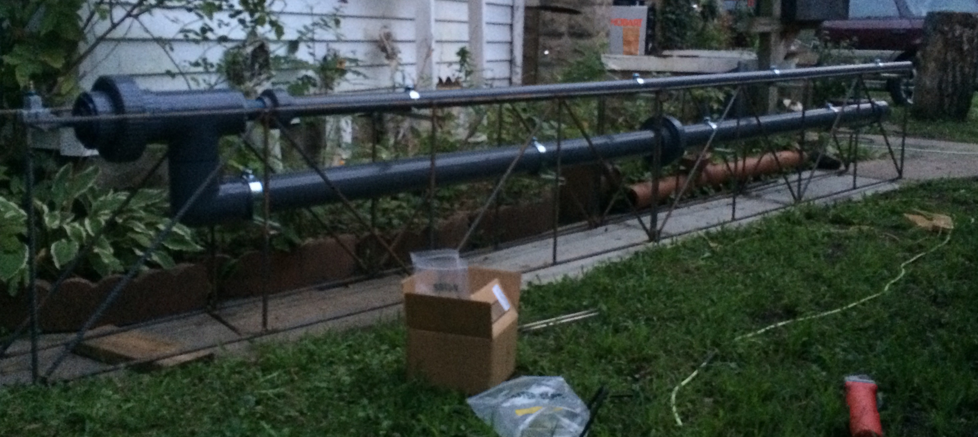

Yeah, I am going to have to look into doing more exact testing of performance. I am sort of new to the whole thing, this is my first cannon. I ended up with a fifteen foot barrel, as that was the longest I figured I could strap on top of the car. The idea being the cannon would be semi portable. I went with the longest knowing I could always shorten it. Right now I am working on a frame for it. I am basically just building a steel truss that it will mount to. Steel seemed excessive for a plastic cannon, but what the heck, it won't cost that much and probably will look better. I will get pictures up, right now I have been using all my spare time for construction.

That looks great, you going to drive round with that on top of your car, maybe its an optical illusion but it looks huge, how big is your car, think you may need a van or trailer

No, you are not deceived. The truss is 1ftx2ftx16ft. It is two 8ft sections that bolt together. The tank is two 7ft sections of 4" pipe that join with a union, and the barrel is one 15' piece of 2". I can get all the pipe parts in and on my car. I moved the truss with a freind's truck. It is all pneumatic. Recently tested up the rated 300 psi successfully. I want to get more info up for you guys but have been really busy. Shot a trailer hitch ball 400+ft. Found a skid mark on the ground at that distance, but the ground drips into a valley so I probably won't ever find it.

It is f'ing massive, sorry misunderstood, I had visions of the cars roof being used as a platform for firing it from, looking like some kind of tank!

I don't see a muzzle brake on the business end of the barrel. Has it occurred to you that the 2" diameter barrel with a large volume of 300 psi air could turn into a "rocket motor" with about 900+ lbs of thrust? How do you hold the cannon in place?wdr0 wrote:Here is the cannon mostly done. I will get the few photos of the build I have and some explanations up sometime soon.

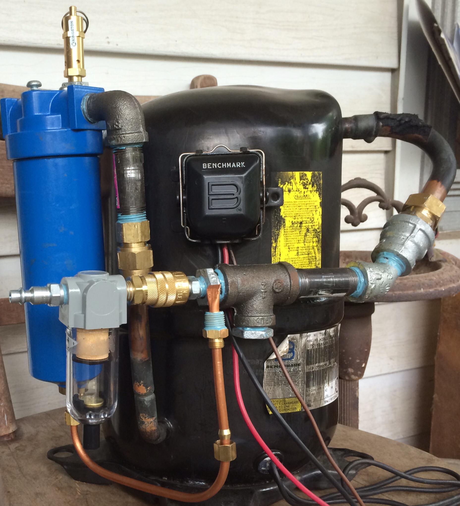

Well, I did a test at 80 psi on my pick nick table and it only slid back about two feet. The truss is welded steel and weighs at least a hundred pounds. I decided to just fire it(from a safe distance) and see how much it moved and if restraint was neccecary. It dosen't seem to move much at all, all together it does weigh at least 200 pounds though. My air pressure source is a central ac compressor pictured below. It only take about a minute per fill with 120 psi going into the compressor. Works great, but does require a 220 circuit(not exactly readily available in the us). The blue housing on the output is a oil filter, the copper line goes to the tee on the inlet. It's crimped to allow a little flow through so the oil filtered out gets sucked back into the compressor. The filter on the inlet is a plain water separator to keep water out of the oil. I don't have a picture of the piston, will get one, the cannon is semi permanently set up at my friends house 20 minutes south of town.
