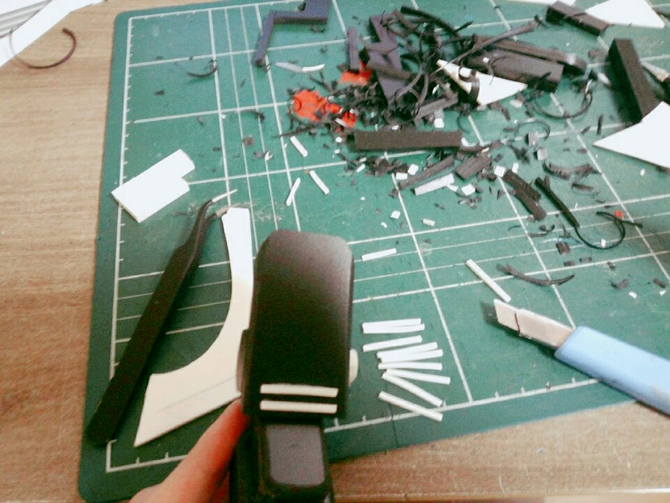

Body part
Body part
hand grip
hand grip
hand grip + red putty
Intermediate check, but I do not like the grip and decided to make it again.

Build the front body
Annnnnd chamber
Annnnnd chamber
