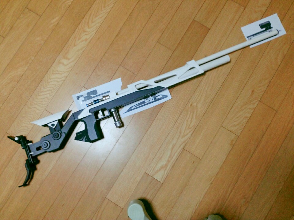

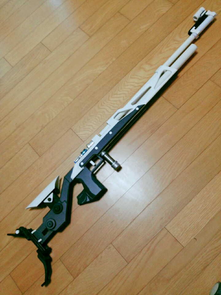

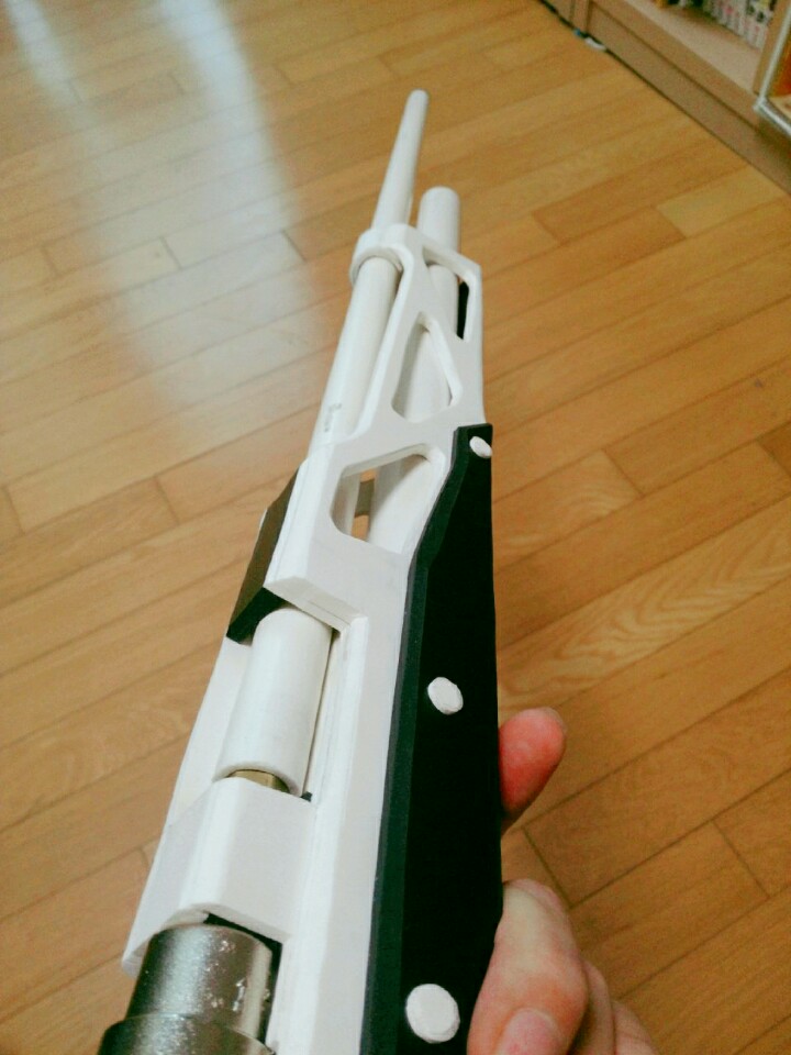

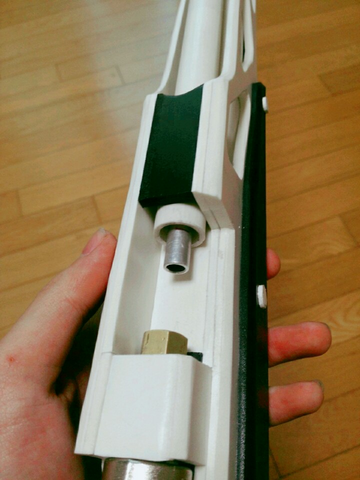

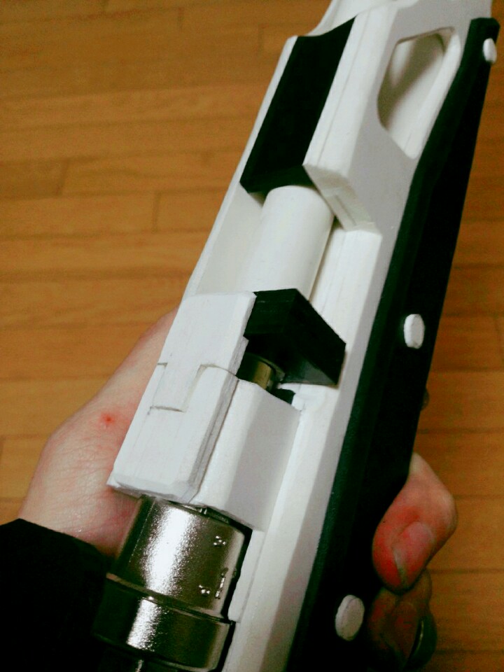

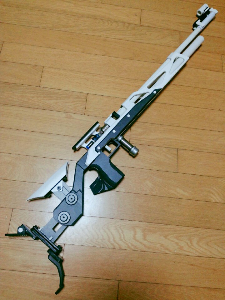

Hello! It's been a while since I posted break-action air rifle
After that post, I was worried about what gun to make again.
As a result, I was able to create an air rifle for the shooting events to commemorate the Olympics this time.

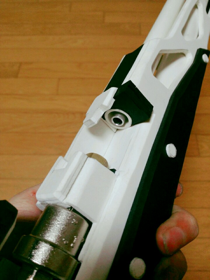

Because of the nature of the QEV unit that I use most of the time, there is a similar feeling to the Olympic Air Rifle because it is a one-shot, one-shot structure.
ammo: 6mm plastic BB (steel BBs are illegal in my country)
pressure: 100~120psi/shot (CO2 cartridge)
I do not have anything yet, so I have a lot of sculptures, but once I have the body, I will trim it before painting.
yeeeah

Wow it looks fantastic.
What size is your chamber and what pressure do you run?
Would like to use the same chamber as yours for a pistol project.
Keep up the great work! 8) 8)
Air2theBrain wrote:Wow it looks fantastic.
thnaks a lot! I use 6A QEV for this project, and previous, 8A
pressure: 100-120, 16g CO2 cartridge.
I'll look forward to your wonderful work.

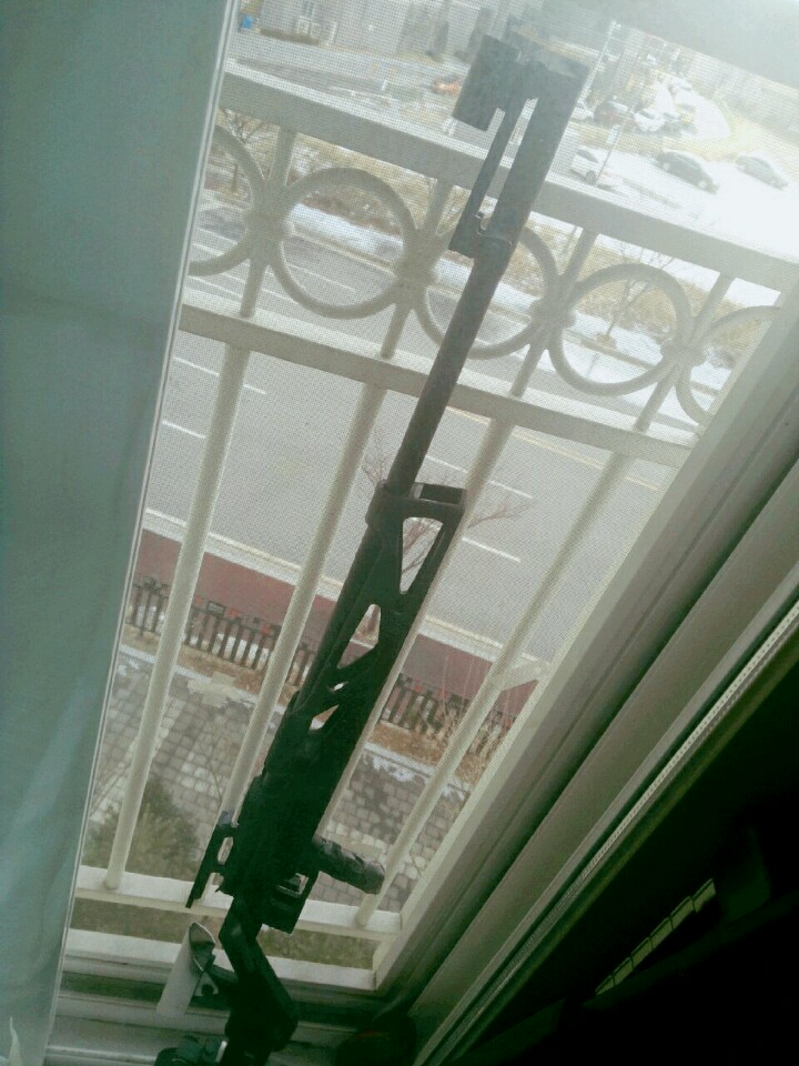

If you worked for Feinwerkbau, this group size would get you fired - but since this is spudfiles and you're firing airsoft BBs, fantastic job!
