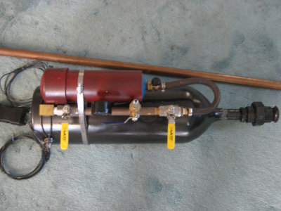

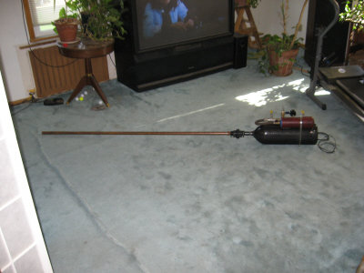

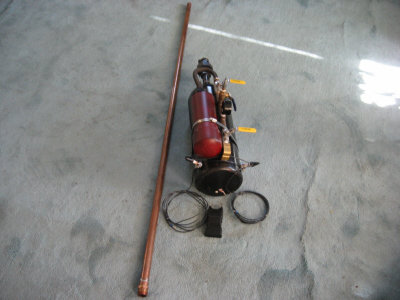

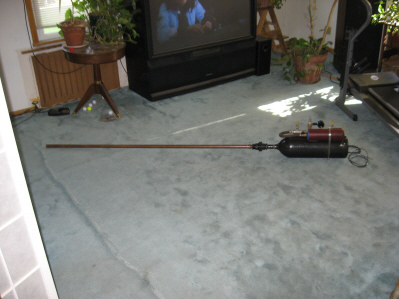

this is my first and newest hybrid!! it took about a month to build and to get the stun gun in the mail. i tapped holes for the propane meter and sprak plugs at my dads shop.

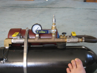

Specs--
1. huge ass 7"x19" fire extinguisher chamber
2. 1"x72" copper barrel
3. 1 peice propane meter (without ball valves, nipples, and reducers)
4. magnetic propane holder.
5. custom paint job (hammered black)
6. stun gun ignition
7. 2 spark gaps (2 spark plugs wired in a series.)
8. 1 1/4 union (valve)
ENJOY!!!
The HAMMER hybrid!

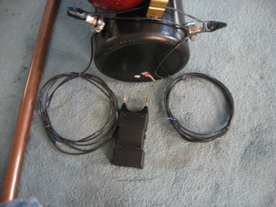

nice, have you shot it yet? what mix do you shoot at?
also, how are the spark plugs set up?

only combustion..im at my dads and i forgot my air compressornice, have you shot it yet?
i plan on taking it to 5x maybe 6x but only after many tests at 5x and before 5x i will test alot at 3x and 4xwhat mix do you shoot at?
they are in a series.. the stun gun wired to the top of one and the bottom of the other.. then wires going to each other to complete the currentalso, how are the spark plugs set up?

only combustion so farhow high have you taken it
sch 80 metal heheis that union sch80 or metal?

How did you attach the union the the tank? Is it a welded fitting or a pre exsiting one? And why is it called what it is?

silver solder and jbweld for extra strengthHow did you attach the union the the tank?
no apparent reason at all..i couldnt think of a name and i used hammered black for my paint job..why is it called what it is?

I'm wondering if wiring the spark plugs in a series robs the trailing spark plug of some power??? Do you have a digetal muti tester with a high voltage plug in?

idk if it robs the power..but who cares hehe.. atleast it works and i still have alot of gap before it goes short circuiting on me. but oh well it works..

Where did you get that cool meter pipe from?

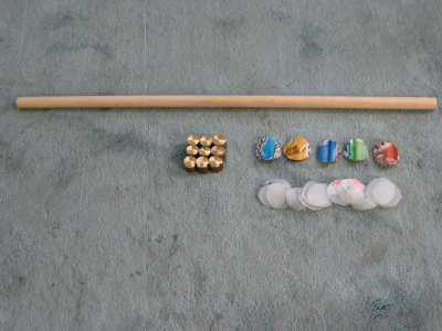

what are you using for burst disks?

You might end up going supersonic with a longer barrel and a high mix(evbec calc'd 1200fps with a 144" @4x)
Anyway, everything looks really clean and sturdy. If I had to complain about something I'd say your spark gaps might be more efficient if they were placed near the middle.

its a quick connect..do you have a bike pump you can use to test it?
i found it in my basement and i have no clue where it came fromWhere did you get that cool meter pipe from?

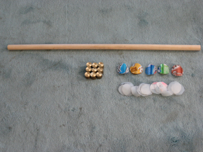

aluminum foil, pop cans, milk bottleswhat are you using for burst disks?
what length would my barrel be to get .3 to 1?a good hybrid chamber to barrel ratio is 0.3:1...
