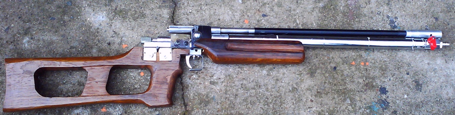

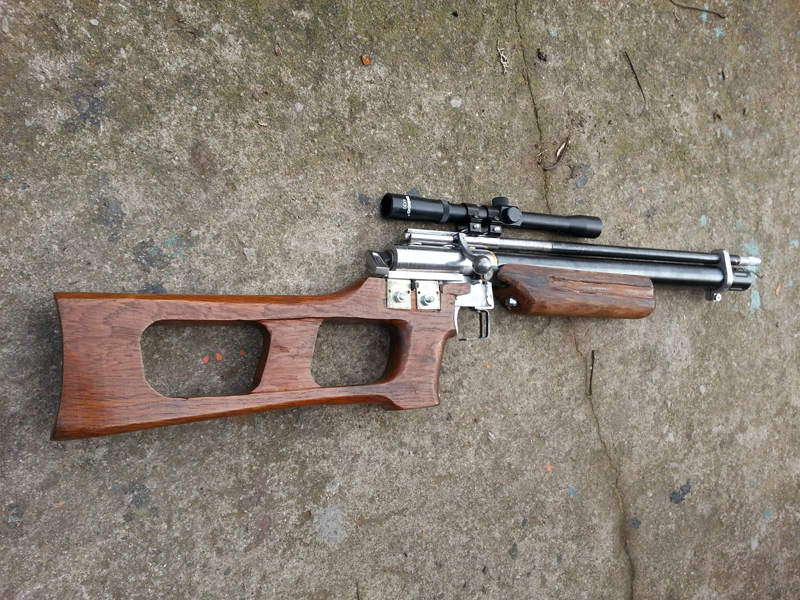

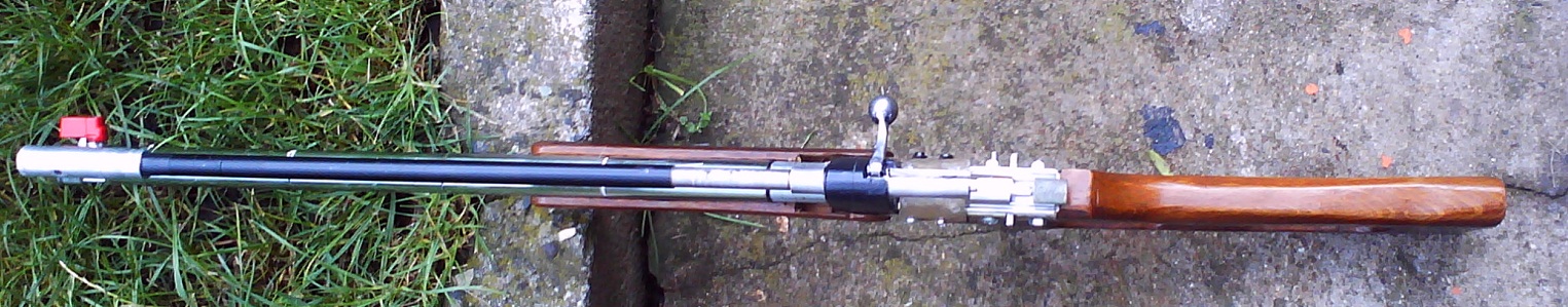

Hello again guys, its time for the third revision of my rifle (now i can legitimately call it this way)
I changed the barrel with 5.5 mm from Hatsan AT44. I was planning to buy 6.25, but i found this one for a very good price. Then i had to change the whole receiver to fit the new barrel. I replaced the ugly safety valve with a Male/Female Extension Nipple and a thick threaded tube soldered together. In the nipple I installed the valve. First I wanted it to be movable and sealed with o-rings but I couldn't put it in without breaking the o-rings when they pass trough the thread of the nipple, so I glued it with polyester resin, but still it leaks a bit. Now all looks a bit more solid and clean (not much but still better than the last version
). I also replaced my air tank with 4 extention nipples , because the old one was leaking. I now have a manometer on my pump. I pump the gun to 12 bars ( I dont want to risk higher preassure because my check valve is self made and it can send the handle in my jaw

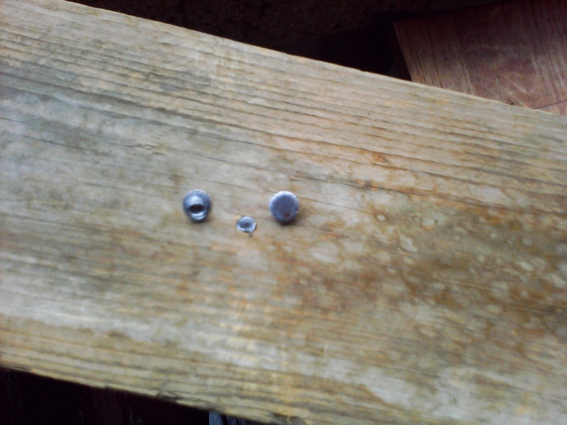

) with this preasure the gun is pretty weak but still it penetrates pine board till the pellet is fully in as you can see on the picture. The other 2 squashed pellets were shot at army helmet from 1 m distance. Can't tell how accurate it is because i dont have sights for now. With 1 fill it gets 5-6 good shots, but after 4-5 fills in a row my hands get tired and i cant shoot accurate so im looking for a compressor.

Sweeet!! Looks much better
Great job, very decent outcome from limited resources, kudos!
Needs a suppressor to be more Vintorez-y though

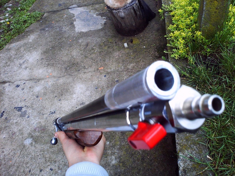

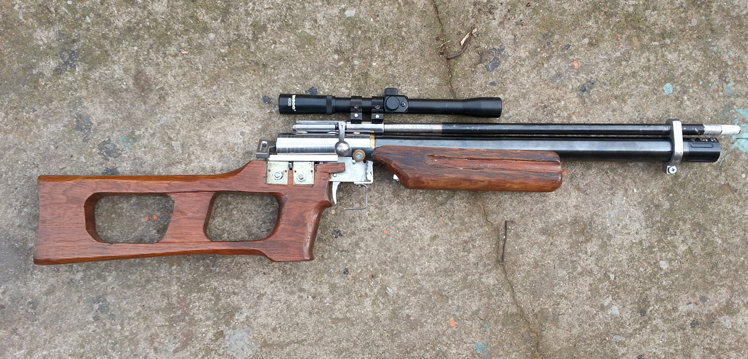

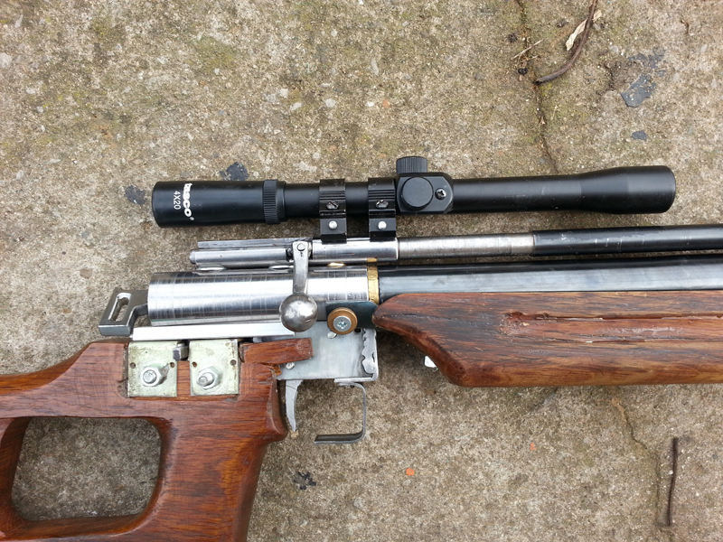

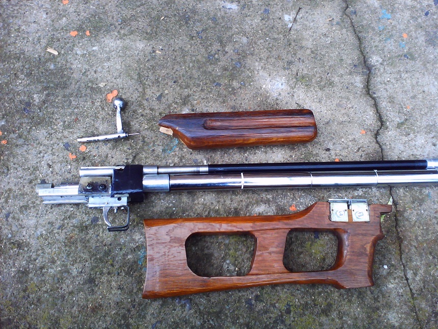

Hello again, its time for the third upgrade of my rifle. Now it has 200 bar air tank, new trigger and everything is fixed with screws - no more resin or soldering. Its much more powerful now , but also very loud. It weights 3 kg , 80 cm. long. The air tank is from hatsan at44 180cubic centimeters. I wanted the trigger to be in front of the sear so i used http://www.enfield-rifles.com/uploads/2 ... rigger.jpg this.
I want to make iron sights so if you have any ideas ...

Looks brilliant! Lets see some videos???
