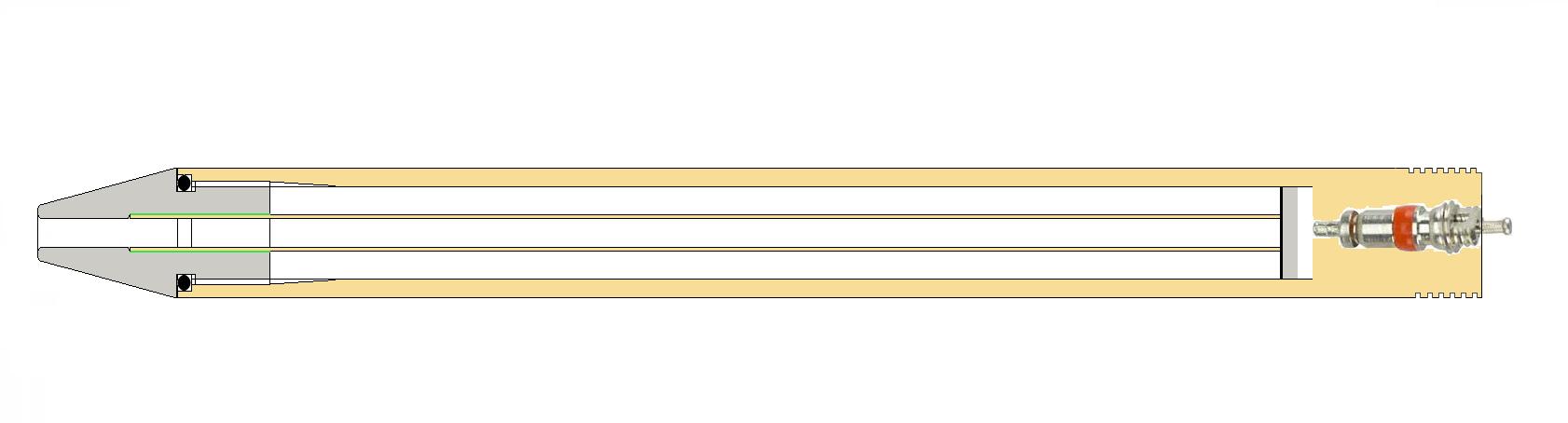

As a result the threads are very shallow. I cut them anyway, as this will certainly be good for the epoxy gripping.

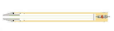

I have updated the general plan to reflect that, no more o-ring there... but the pengun is still serviceable. Yes JSR... now I remember, you told me exactly that :notworthy: I shall doubt no more :notworthy: I shall doubt no more :notworthy: ...
And the cutting plan that I followed:
