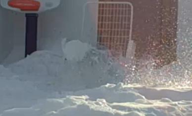

When I pilot the gun my digits are well clear of the exaust :wink: And about the locking breach I don't think it is nessasary and even though, there isn't enough room between the 1/2'' and 3/4'' pipes, any ideas are welcome. Thanks for the comments.[youtube][/youtube]
freeze frame I think it's cool
freeze frame.jpg (10.77 KiB) Viewed 4517 times
