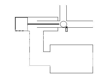

This is my Blow Forward Bolt/Breech idea, since I'm only 13 I don't have access to a lot of equipment... So I tried to design this with that in mind...
It's basically a coaxial piston gun with a bolt attached to it that pushes the ammo forward to avoid double feeds. I left out the spring detent of the animation to keep it simple for me to make...
Questions, Suggestions, Flames?

If I'm thinking of what you want to do then flow will be useless and deadspace will be massive.
Why not a toolies valve for this?
Posts: 3643
Been thanked: 62 times
Well, when the bolt moves back after the piston opens, you have the potential for a double feed, so what does this solve?

mark.f wrote:Well, when the bolt moves back after the piston opens, you have the potential for a double feed, so what does this solve?
Not if he used really high pressure and small volume of air. Because all the air would of escaped before the piston would have time to fully return.

I would try this in a tee piston valve because then you could reduce dead space to a bare minimum, because with this your chamber size determines bolt length.
Other than that it has potential.

Gaderelguitarist wrote:I would try this in a tee piston valve because then you could reduce dead space to a bare minimum, because with this your chamber size determines bolt length.
Is this what you're talking about?
@Mark.f: And with the double feed situation, I added a spring detent in the diagram.
@Inonickname: How would you suggest I build this?

And with that said, Do you think I could use a blow-forward breech with a QEV+Pop-off combo?

@MountainousDew, Your design in the original post (top) looks very interetsing,
But it also seems WAAAAY out of scale.
To block the magazine it just needs a more solid longer bolt.
Also, the chamber volume should be much more to the front, otherwise, how will it pilot? 8)
EDIT: forgot, with the bolt blocking the mag, it seems the pressure will have no way out the barrel, Unless a seperate pipe vents the chamber behind the projectile. Seems like you're onto something though. :) :wink:

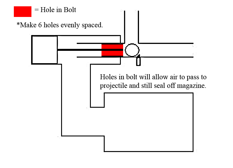

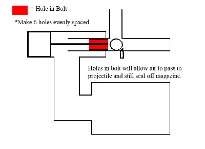

Problem solved. And all you need is a drill.
I like it a lot. Instead of 6 holes a center pipe for a single large port for better flow could be used. I'll have to bookmark that one. The hole in the piston and push bolt, changed to pipe can be the same diameter as the barrel with a simple bolt crossing the end to keep the projectile out of the piston push bolt assy. Kudos .. I like it a lot.

Not sure I understand what you mean. Are you saying the bolt itself would be a pipe connected to the piston with a few holes cut in the sides? Wouldn't having a bolt the same diameter as the barrel require some modification of the Tee?
MountainousDew said he doesn't have much access to machines. I was just going for a simple to construct design.
