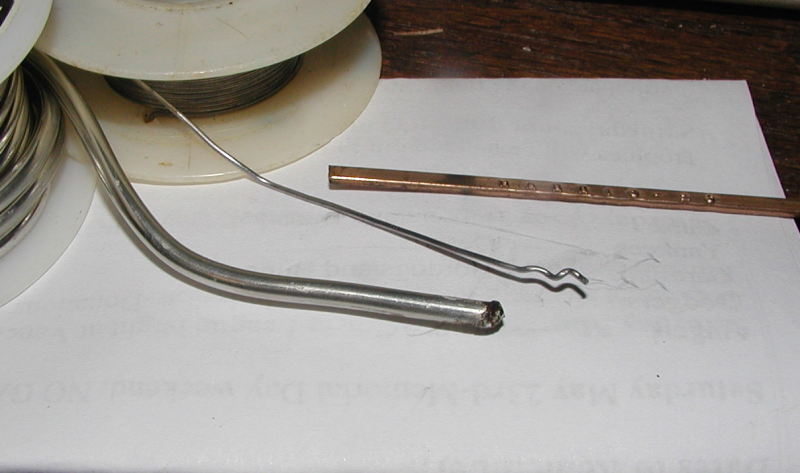

Edit, Grabbed the camera and took a photo of all three types.
Silver bearing solder is in front.  Nice and shiny  with a silver color.  Behind it is electrical lead tin electrical solder.  The copper colored rod is 15% silver brazing solder.  On copper pipe it looks a lot like electrical solder in color, but it is very hard.  Soft lead based solder will write on paper.  The other two will not rub off on paper.
