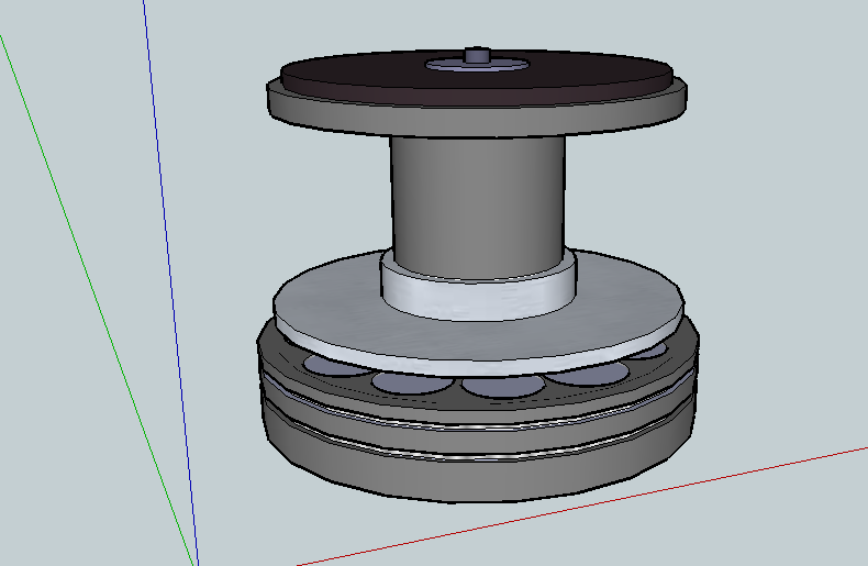

Hell...you could make this piston. I designed it for my soon to be rifle. Teflon or HDPE body, integrated high flow check valve.<br /><br />Valve in open position, spring not pictured
