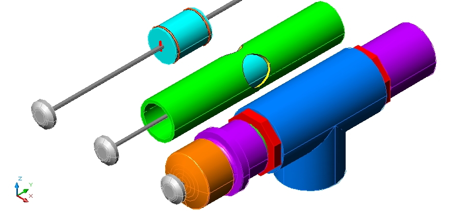

Here is a preliminary CAD model for a QDV in a Tee.
The Tee (Dark Blue) is a 2 inch that has 2 to 1-1/2 bushings (Red) on each end.There are Adapters (Purple) that are threaded on each end.
Male end gets a Cap (Orange) and the female is barrel side.
The chamber port is yet to be determined.
The piston pipe (Green) is 1-1/2 inch with 3 holes at 1-3/8 inch.
The piston (Light Blue) is 1.590 x 2.250 long with 2 O-rings.
The piston is mechanically actuated via Pull handle attached via 3/16 Rod.
The bumper is not shown yet.
Open for constructive comments and criticism.

nice looking cad, i get what you were trying to show last time now.
One question, why don't you just make it 2 separate sections of pipe instead of having 3 holes I'm sure it would help increase performance.
I would also make the housing just long enough to get full porting and the cut the pipe down for a more compact valve
Very nice. For an FYI, rectangular ports open more area suddenly with the same piston speed as more area is exposed in the same movement. I use rectangular ports in all mine for that reason.
For larger porting, the threads can be ground out of the T and a 2 inch valve body made and welded in. A single port facing the inlet would work well. I am considering building one this way just to see if it can be done. If it works, I may build a 4 inch so it is easier to aim than a coaxial with a large diameter chamber.
I learned a lesson making this. Sand it smooth before cutting the ports. The ports snag the sandpaper. The Marshmallow cannon got sanded then the ports cut. It made a much nicer valve.

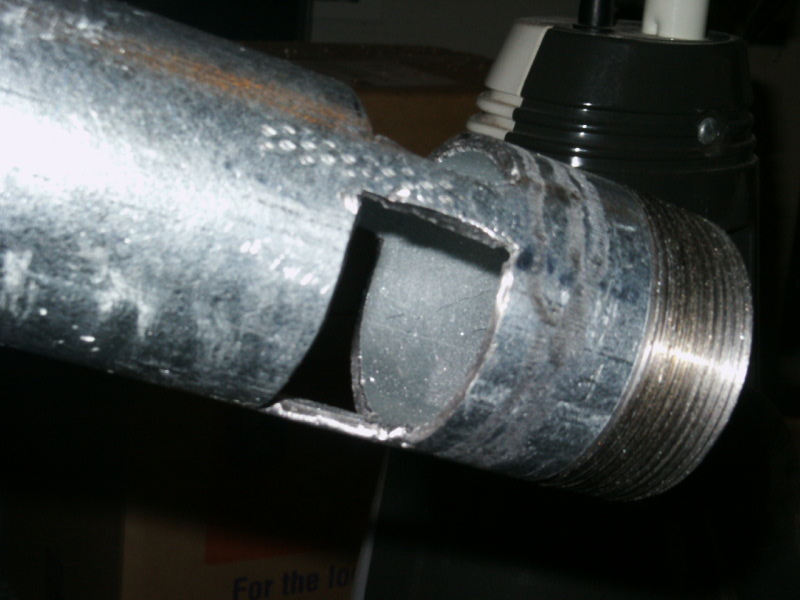

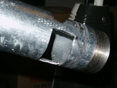

2 inch QDV valve ports.  This photo is prior to massive sanding inside and rounding of all edges.

spudtyrrant wrote:nice looking cad, i get what you were trying to show last time now.
I think you are referring to hubb's drawing aren't you?
The alignment of two different pipes will be very difficult!
Tech; I can easily change the ports to rectangular, I also did not show any chamfering on the ports either.
I was also concerned about the handle rod. I will have to investigate that further.
Keep up the good suggestions!

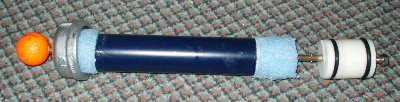

you know that you could attach an air cylinder to the rod and use it to open the main valve ?
to avoid air losses when the main valve is in open position one could attach a valve that would open to fill the gun when the piston is closed position.. it wouldn't really be that difficult

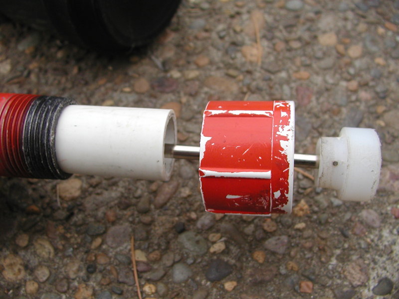

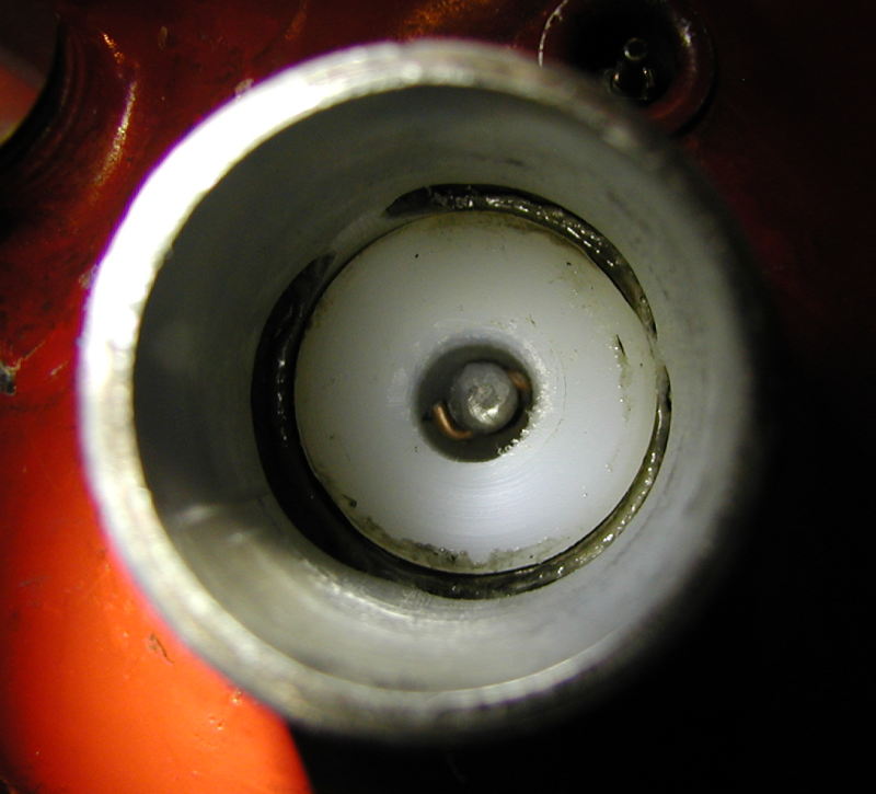

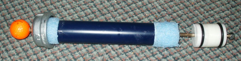

I put a mechanical piston stop internal to my valves so the reset pin has a location to retract into behind the bumper. When the piston flies open the piston can't hit the pin on the way back. It is already retracted into this space before the nut or pin on the other side of the piston hits and starts to move the piston.
The stop assy does not have to be this long. In the cannons it was made this long as it was decided to locate the ports near the far end of the chamber nearest the screw on barrels.
The pins in both my cannons are 1/16th of an inch. The 2 inch uses a nut on the end of the rod. The one inch uses a pin.
The hole in the bushing on the stop assy is large enough for the reset pin to retract through.
The valve core assy.  Behind the bumper is a stop assy the reset pin retracts into before the piston starts to move open. The reset pin can be seen between the piston and bumper.

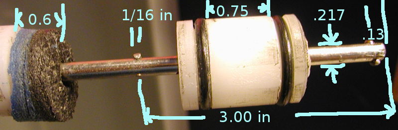

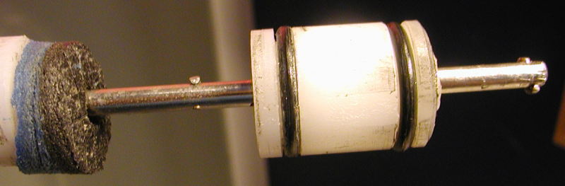

I just shot a picture to show the detail of the two pins that move the piston.  At the far left is the end of the stopper assy behind the bumper.  That poor bumper looks like it is due replacement.  It has taken a beating.<br /><br />The pin doesn't need to be huge and strong. The piston is easy to move.
The 2 inch valve uses the same 1/16th inch reset pin, but uses a nut on the end of the rod to open the valve.  This old style bumper was a failure.  It simply got pounded into the tube.  This was later upgraded with a bushing on the end of the tube the same as the Marshmallow Cannon.

Excellent CAD drawings!
Of the thousands times I've looked at Tech's creations,
I FINALLY fully understand the valve now!!!

THUNDERLORD wrote:Excellent CAD drawings!
Thanks, hopefully my drawings approximate the theory of operation of the QDV by Tech.
@Tech; Thanks for the close up photos for the piston/rod assembly.
I will be updating the model with your recommendations. They are greatly appreciated.
The model updates will include bumper/cushion and sliding piston with front and rear piston stops.
Thanks you all for the suggestions! If there are more ideas I will consider them.
Watch this posting for more improvements and suggestions.

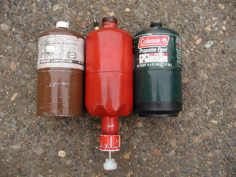

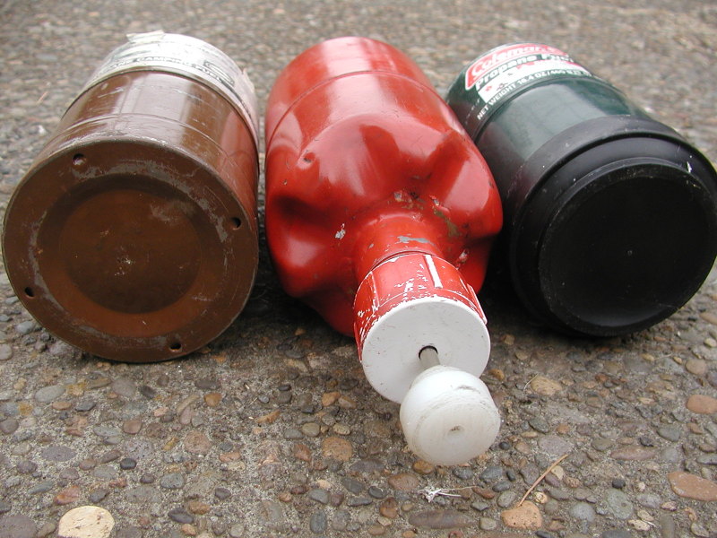

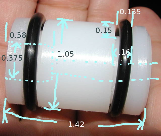

I grabbed some measurements off the 1 inch to get you started modeling it. I put them on the following photos. If you have any questions as to what any of the dimensions go to, pm me.
The 3/4 inch pvc insert is 6.75 inches long. On the end is a machined bushing 3/4 inch thick with a sholder 0.2 inches on the end behind the bumper. The hole in the center is 0.375 inch in diameter, the same as the recess in the piston. The pins are steel welding rod. The rod is finished off by extending out the end of the pipe and a knob attached at the point where it hits the cap right where the piston is in the proper closed positon. These dimensions will vary depending on your selection of the pipe cap and how far it screws onto your pipe nipple. My overall rod length is 12.5 inches long. My knob is 0.838 inches long. The large diameter is 1.05 inches and the small diameter is 0.75 inches.
Edit; Added pictures for Dewey without bumping the thread.

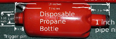

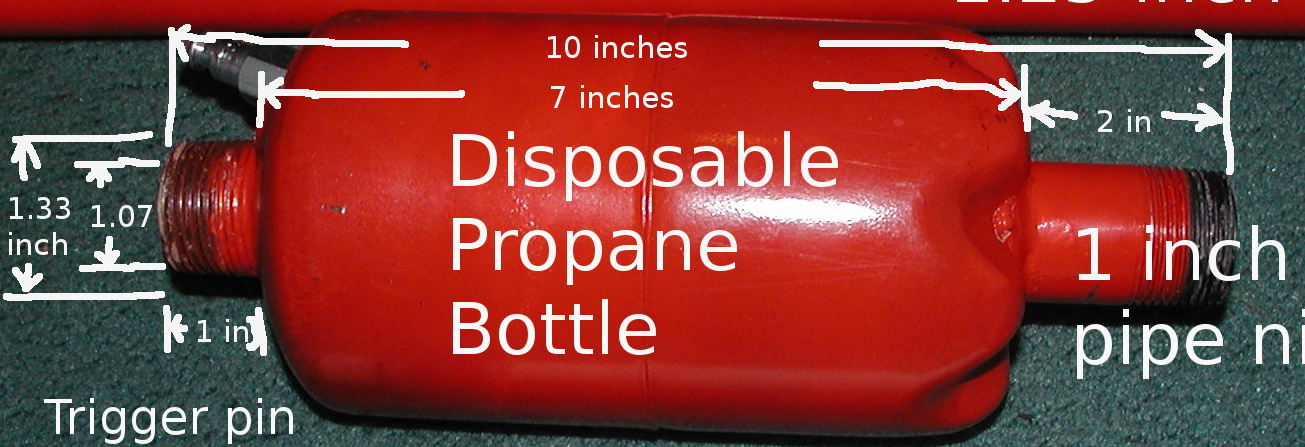

Dimensions of the tank assy.
Dimensions of the 1 inch piston.
Spacing of the stops and rod size.
Detail showing the rear of the 3/4 inch pipe, the 1 inch cap, and the knob mounting detail.

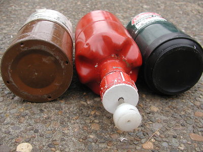

Tanks on the side.  The launcher was made from the Coleman tank.  The plastic foot is removed to reveal the 6 feet.
Propane tank bottoms for comparison.

POLAND_SPUD wrote:you know that you could attach an air cylinder to the rod and use it to open the main valve?
Or combine it with a pop-off valve to make the ultimate reiprocating auto valve :D
@JSR
you'd need a pop off valve with threaded port to attach an air cylinder and it'd would have to stay open long enough to let the air return from the cylinder back to the main chamber
since you're an expert on pop-offs and farting machines :wink: do you think it'll stay open long enough ?
of course the biggest advantage of my design or using a pop off is that you wouldn't need to use a 3 way valve at all and the fact that the bolt could be directly attached to the piston... since the piston is directly attached to the gun this means that there would be enough force to cycle to gun reliably
