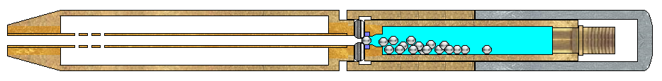

A major improvement would be going "valveless" - bigger bore, zero "opening time", full flow.
edit: even better, imagine a "valveless" full auto integrally suppressed pengun :D

hahaha... I love the full auto one... :D

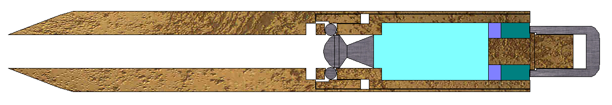

And how would you charge it if you have to have that cap on to hold the ball in place?

The cap seems to be in two parts... the brass one holds the ball while the aluminum one is just an extension.

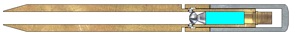

Up the calibre to 3/8" and you get some serious muzzle energy
:shock: :idea: :?
I HAZ A BANG!
LeMaudit wrote:Image
Yes you can :D
Of course this would be best a simple single shot launcher for a cartridge...

Cartridge pengun :D
I love the full auto one but I doubt you'd get more than 3 shots off. Still... Full auto pengun, cartridge pengun, valveless pengun, oh the things JSR can build with Sherline :)
FighterAce wrote:The cap seems to be in two parts... the brass one holds the ball while the aluminum one is just an extension
Well spotted :)
A slightly modified cartridge version, with a removable rear cap. This would allow either the skirt of a diablo pellet type projectile to be flared against the walls to provide an effective seal, or a silicone sleeve to be inserted that would seal a hard projectile like a steel ball.

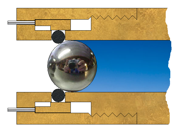

Jsr is there any way you can think of making the detent out of an oring rather than ball bearings, because that would eliminate the need for another seal. The only problem is I can't think of a way to hold it in.

Use a thick o-ring and recess it far into the walls?

Gun Freak wrote:Jsr is there any way you can think of making the detent out of an oring rather than ball bearings, because that would eliminate the need for another seal. The only problem is I can't think of a way to hold it in.
I've been thinking about that for a while, it's not an easy proposition. Here's one way I had though up but it's too complex for my liking.
